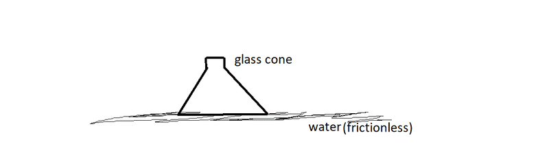

No. That's not what I meant. I am doubtful in the independence of both types of motion. I am trying an experiment but I don't know how can I apply constant force each time. Plus when I apply force offcenter the body deflects from the original path.
Possibly it is time to actually learn the math. It is not like ##\sum F_\text{ext} = m_\text{tot} a_\text{cm}## is terribly difficult.
Then you can do a thought experiment. Consider a bar-bell type object. A thin and nearly massless rod connecting two massive balls that are small compared to the length of the rod.
Apply (on paper) a small force on the right-hand ball for a small time.
Consider the resulting motion of the assembly. How fast does the center of mass move? In what direction does the center of mass move?

I think I got you. Its because its difficult to keep up at the end of a pencil(less mass) than at COM(more mass) when applying the force on its end that we are unable to provide it same momentum. We are unable to apply force for the required time. That's is why my glass cone on water experiment is failing. It is not covering the same distance when applying force off center.
Similarly the work done also becomes less since force is applied for lesser distance and so reduced KE for rotating object. Difficult to do. Yes?
