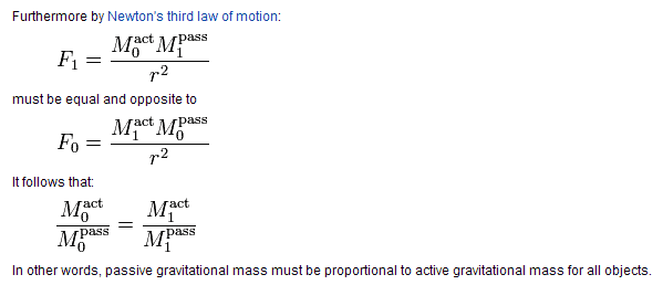

I like your explanation, and I agree. However, why does it not work for the case of gravity? To be more specific, I'm talking about the mainstream classical justification for the equivalence principle as it applies to active gravitational mass. Let me give an analogy that applies to the OPs question:
Two men with a rope are standing face to face on a frictionless surface (or ice). Regardless of which man pulls on the rope, one, the other, or both, they will always meet at their center of mass. Just as your post describes, the third law does not discriminate between the action and reaction.
However, it does discriminate for the case of gravity:
http://en.wikipedia.org/wiki/Equivalence_principle#Active.2C_passive.2C_and_inertial_masses
In fact, the equivalence principle depends on the discrimination! In the two body problem, if the gravitational field of M1 disappears, then the third law will be violated (they will not meet at their center of mass). And this is used as the justification for the equivalence of active gravitational mass and passive gravitational mass, even though there is no physical evidence to support it.
Am I missing something?

You are missing that the cited wikipedia article is yet another reason to avoid wikipedia.
There is no such thing as active versus passive mass in Newtonian mechanics. There is only mass.
Thanks for the response DH. Yes, I realize that wikipedia is not the best source, but it was convenient and the quoted section does agree with other mainstream sources I have encountered, such as:

My question is: What reason do I have to believe the wiki quote in the op when there is no physical evidence that a third law violation would occur when [itex]M^{pass}_1<>M^{act}_1[/itex]? In my analogy of the men with a rope in a tug of war, if one man pulls and the other does not, there is not going to be a third law violation. The same can be said for electric charges or any other example you can think of. So why should I believe the third law will be violated in the case of gravity?
The third law would be violated. The third law says if I pull you, you must pull me. That causes active and passive charge to be the same.
Okay, that makes sense. But it was my impression that active gravitational mass referred to the strength of a bodies gravitational field (or charge). If that is true then what does passive gravitational mass refer to? Does a body have two gravitational fields? That doesn't make much sense.
Let's say it is possible for the sun to pull the earth, but the Earth does not pull the sun. This is approximately true since the sun is much more massive. Then the force of the Earth on the sun is 0, so the Earth has no active gravitational mass. The Earth is affected by the sun, so it has passive gravitational mass.
Newton's third law says that this description is not exactly true, and in fact the Earth does pull the sun.

Taking it in stages,
  • In Newtonian mechanics, the mass in F=ma and the masses in F=GMm/r2 are one and the same. Reading through Newton's papers, I don't see any sign that he saw any distinction at all between the inertial mass in his second law of motion and the gravitational mass in his universal law of gravitation.
  • Einstein saw that those equations left an opening for a distinction between the two concepts of mass. His equivalence principle says that inertial and gravitational mass are one and the same thing.
  • Bondi saw yet another possible bifurcation in Newton's law of universal gravitation. This is where the concept of active versus passive gravitational mass first arose.
What Einstein did and what Bondi did are very different things. While both Einstein and Bondi pointed out implicit assumptions in Newton's theories, that is where the similarity ends. Einstein's equivalence principle make Newton's implicit assumption explicit. He did not ask "what if those concepts of mass are different?" Instead he asked "what does inertial mass and gravitational mass being one and the same mean?" This line of questioning was the key to general relativity.
Contrast that to Bondi's concept of active and passive gravitational mass. Before Bondi, the distinction between the two just didn't exist. His distinction adds nothing new to physics if they are one and the same thing. If they are not necessarily the same, all of the conservation laws go out the window.
