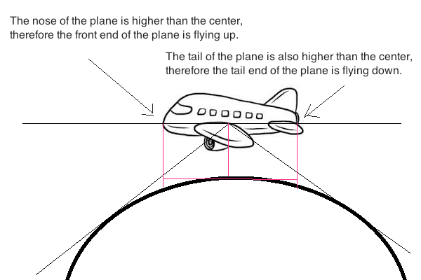

  • #44
sophiecentaur said:
The angle is surely too small to be significant (angle between chord and tangent?). i reckon it will be l/r where l is the length of the plane (say 20m) and r is the Earth's radius (6e6m) is that worth bothering about?
Not if you have a REALLY big plane.
In which case, I'm not sure if the plane is flying up or down.
I guess it depends on where you are seated.
What a great distraction! And you managed to make me think twice about it Grrrr.
But no part of the plane is increasing or decreasing its height above ground so, wherever you are sitting, The centre of the plane is a tiny bit closer than the rest and if the pilot has managed to eliminate all other factors and is concentrating on what we are discussing, no one is going up or down.
