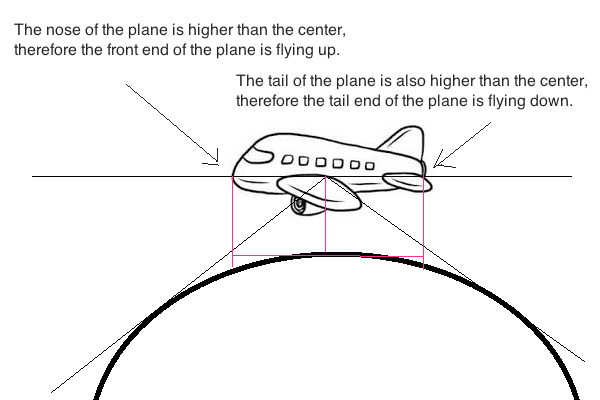

  • #67
OmCheeto said:
Not if you have a REALLY big plane.
In which case, I'm not sure if the plane is flying up or down.
I guess it depends on where you are seated.
thats a great diagram.. I was explaining it that way to my pilot father and we both scratched our heads. obviously, its the reason there is NO adjustments to the controls once level flight is established. BUT, if the world suddenly became flat, would the forces be the same on the aircraft ? can the relative wind be curved? and if so, with a straight wing, if the wind straightened, what would this oversized plane do?
i was thinking a lot about your picture, and you need to change it. the nose and tale are same distances respectively to the ground, regardless if we are talking flat or round earth. the way you drew the picture, the distance of the nose and tail to the ground increases, but it is the distance to the ground on route to the Earth center on a round earth. the distances would be the same...round or flat.
