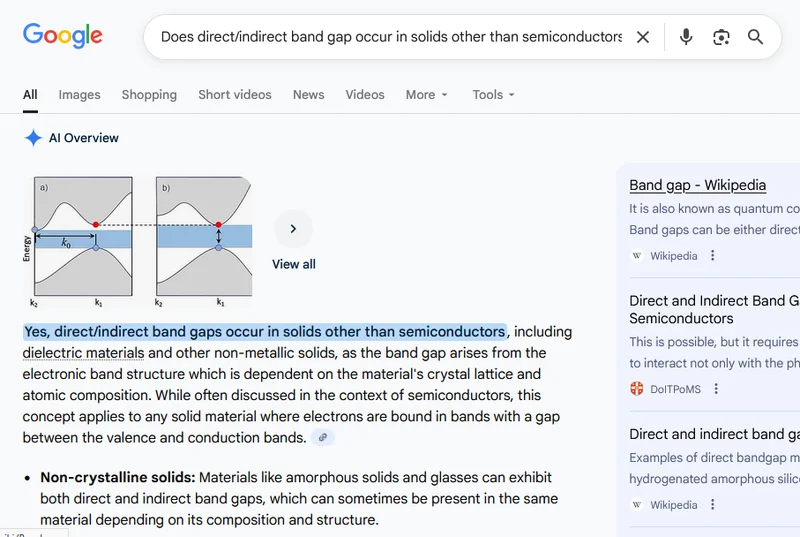

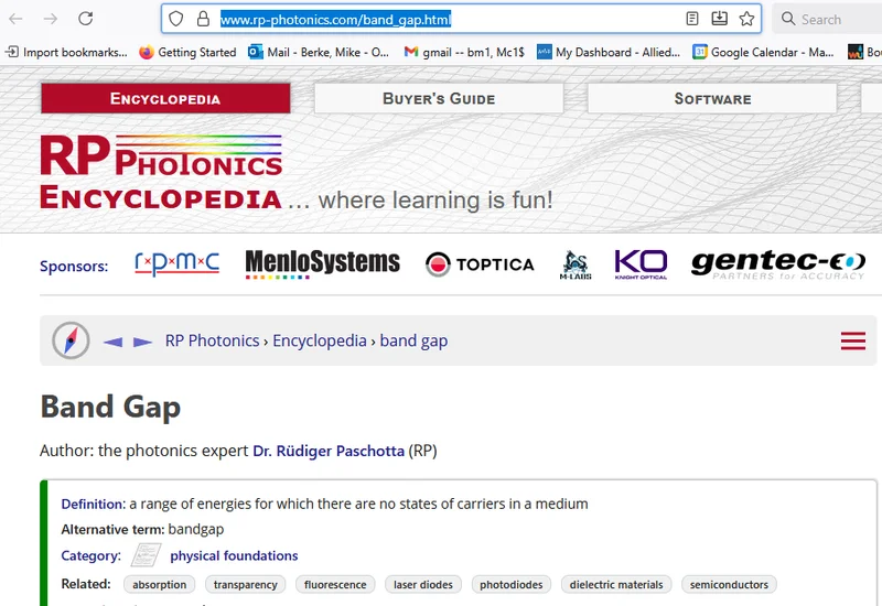

Please calm down. The reply by @Baluncore was meant to be helpful without outright giving you the answer to your question. It is ironic that you say that you know how to look this up on wiki/Google, since that will give you the answer directly. Your original thread title was pretty terse, so I added to it to make it more descriptive about the same time that Baluncore replied. If you do a Google search on the better thread title, you will see your direct answer.
Unfortunately, Google uses AI for its initial answer, so you cannot trust it. I post the AI answer below, along with one of the first real hits that helps with the answer you were seeking.
This thread is reopened provisionally in case you have questions about the answer you can get by doing the Google search that I did.
https://www.rp-photonics.com/band_gap.html

One could have searched on "direct/indirect band gaps in metals, insulators, dielectrics, . . . . " When I searched on "direct/indirect band gaps in insulators", I found the artlcle berkeman cited, "Band Gap" in the
RP Photonics Encyclopedia, which mentions other forms of matter besides semiconductors.
