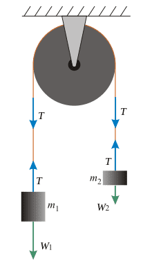

Consider Atwood's machine with two masses, m1 and m2 with m1 less than m2. Now, according to application of Newton's third law, the system accelerates in the direction of the heavier mass (here, m2). This, however, seems to contradict Newton's third law, which implies that the interaction between the block and the rope are equal and opposite. That is, the tension of the string should counteract the force of gravity on each block. Obviously, though, there is a fallacy someplace in my argument. Does anyone mind pointing it out?

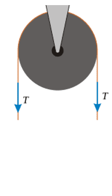

Going by my applied maths textbook and having a quick look at a diagram for an attwood machine. It appears that the force acting on the pulley is eqivilent to 2 times the force of tension in the string over it.
I'll do a quick diagram to show why.

Heres my quick diagram.
Free-body diagram of an Atwood machine: a pulley hangs from a ceiling bracket, with masses m1 and m2 on either side of the rope, each labelled with tension T and weight W.
Then consider the pulley and only the forces acting directly on it.
Diagram of a grey pulley hung from a grey support bracket, with a rope over its rim, showing two downward blue arrows labelled T on the two strands of rope.
  • Free-body diagram of an Atwood machine: a pulley hung from a ceiling, with masses m1 and m2 on either side of the cord, tension T arrows on each cord segment, and weight arrows W1 and W2 acting downward on the masses.
  • Diagram of a grey pulley hanging from a grey support bracket, with a cord wrapped over its top and two vertical cord segments hanging down each side, each labelled T with a blue downward arrow.

well Syrus, you can still see by his diagram that all of the tension in that set-up cancels out, thus we are left with only the weights, and they are unbalanced

You should apply Newton's 2nd Law to the masses. Let's look at the heavier one, in a free body diagram. Let's say it has a mass of 20 kg, or a weight of 200 N. Newton 2 says that
[itex]F_{net} = ma[/itex], and since the net force is 200 N down and T Newtons up, then
[itex]200 - T = ma[/itex]
Now since the system is accelerating and not at rest, then the acceleration is greater than 0, and thus, T must be less than the gravitational force of 200 N.
The tension of a string wrapped around a frictionless and massless ideal pulley is always the same on both sides of the pulley.
Newton 3 holds for all cases of accelerating or non accelerating bodies. In this case, the rope exerts a force of T upward on the 20 kg mass, so the mass exerts an opposite force of T downward on the rope. T is not equal to 200 N. Newton 3 refers to equal and opposite forces on different objects. Newton 2 applies to forces on the same object.
