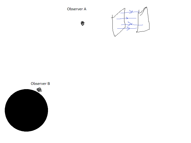

Thanks for the reply! My apologies for being unclear. Two observers look at a test charge between the plates of a charged parallel plate capacitor floating in space far from the Earth. Observer A is near the capacitor and the capacitor's rest frame, while Observer B is located on Earth. See attached. My question is what kind of field does Observer B see if Observer A sees a uniform electric field between the plates? Let me know if there's anything that needs clarification.
A uniform electric field between the plates. The only thing that will change is that the energy stored in the field will seem larger to Observer B, because of gravitational blueshift.
That is surprising but cool. Thanks! Sorry again for the poor explanation in the original post.
About the method I would use to derive this result, it seems as though the Einstein-Maxwell equations aren't necessary in this case on the same grounds that we don't need the Reissner-Nordstrom metric (the electromagnetic field due to the capacitor has negligible effect on the metric). Am I correct in that the only field equations needed are the (covariant) Maxwell equations? How would I calculate the field seen by Observer B? In my earlier post my thoughts were to take the covariant derivative (using the Schwarzschild metric to compute the Christoffel symbols) of the Maxwell 2-form and integrate ##\nabla_{\sigma} F_{\mu\nu}## along a parametrized world line from Observer A to Observer B. In light of the confusion with the problem statement, may I ask again if this is a valid approach?
Yes, because the electromagnetic field is so localized that you can ignore spacetime curvature when describing it; you just have an ordinary capacitor in a small patch of spacetime that can be approximated as flat. So you just have the ordinary description of a capacitor without having to worry about how it interacts with gravity.

PeterDonis said:
No. The EM field is zero except in a small patch of spacetime where the capacitor and whatever is charging it (a circuit with a battery, for example) is located, and, as above, that small patch of spacetime can be treated as flat.
Just to make sure I understand, is what you're saying that both observers see the same electric field (as opposed to uniform electric fields with different magnitudes or directions)? I'm still not sure I see why this is. I agree that a small neighborhood around the capacitor and Observer A can be treated as flat space, and I agree that a small neighborhood around Observer B can be treated as flat space, but the spacetime between is curved. Aren't these two distinct local flat spaces connected by the curved spacetime described by the Schwarzschild solution? What makes them identical?
They're both locally flat.
They are far enough apart that we will notice curvature effects (such as gravitational redshift/blueshift) if we move between them, but that has no bearing on the local physics within each patch - both patches are flat, both patches display the same locally flat physics.
One way of seeing this is to remember that the E and B fields at a point are defined by their action on a charged test particle: ##\vec{F}=q(\vec{E}+\nabla\times\vec{B})##. How does a test particle between the capacitor plates behave according to an observer near the capacitor? Does it appear any different to the earth-bound observer?
No. I said the energy stored in the capacitor will look larger to Observer B (who is much deeper in the gravity well than the capacitor and Observer A). That implies that the electric field will also look larger in magnitude, since the energy and the field magnitude are related. But there is no easy way for Observer B to directly measure the electric field inside the capacitor, which is why I focused on the energy storage, which is easier for Observer B to measure (for example by looking at the energy of light emitted by the capacitor as it discharges).

Twigg said:
I would like to know how I would derive the transformation which would send the electric field seen by one observer to the field seen by the other.
The easiest way is to transform the energy, which is just the gravitational redshift/blueshift formula, and then calculate what electric field magnitude would produce the new energy. (Basically, the energy is the field magnitude squared, with some constant factors that depend on your choice of units.)
Notice that this transformation has nothing at all to do with Maxwell's Equations in curved spacetime.
