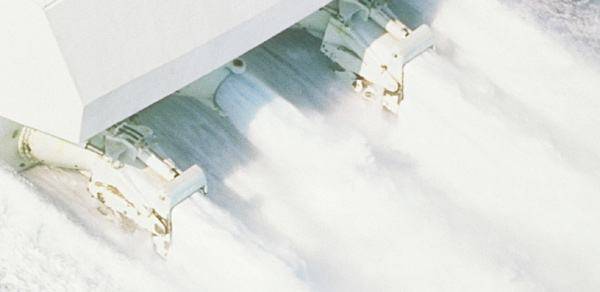

http://www.ship-technology.com/contractor_images/rolls/3_water_jets.jpg

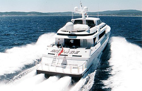

http://www.yachtforums.com/forums/a...heesen-yachts-mirage-1992-heesen-mirage-1.jpg

I found a pic showing the jets in operation:

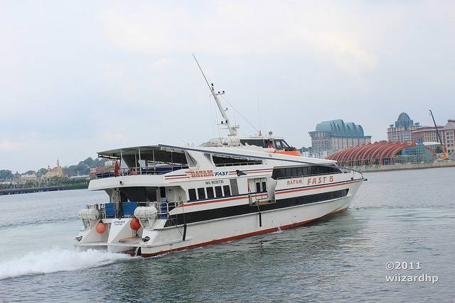

This is the boat I used to ride all the time:
... in motion The Jet Raider nozzles are slight...ed to [i]surf[/i] the waves into the harbour.
I've never seen a waterjet yacht underway on the open sea that wasn't planing. I guess ferries might not as it upsets the old ladies. Never really look at the ferries.

BTW am considering your photo and she should be able to plane at her length (as you know, it planes when the bow wave length exceeds the hull length. That might not be technically correct as I sail better than I do maths, but it's the concept of it)
edit: she does seem slightly bow up in the video but isn't planing
edit: boats that length can plane on screws. is she speed limited or did they go for jets due to requiring shallow draft? that might fit will with your experiences of plant crap in the intakes. You get a lot of stuff floating about in shallow water.
The Jet Raider was out of action far more often than the screw ferries that did the same route and suffered a lot from engine overheating ... more, I don't know. I only rode the thing.
iirc: What usually clogged the intakes was plastic bags.
You are right, it didn't plane any more than a regular boat - but more than the cats on the same route. She could go faster than in the video ... and very manoeverable. I've not seen her plane more than 15-20 degrees (from memory - if I squint: the inside had airline-type seats), but I have been a passenger when she leaves the water at the top of the crests.
I guess there's a reason ferries tend not to be jetboats. I don't know what the rationale was to run her in Auckland Harbour but when new was the fastest boat doing the Auckland-Waiheke Island run.
Most recently there was a fire.
iirc there are slow jet ferries doing the whale-watching and dolphin-watching runs too - deep water but screws damage the animals.
The smaller boats on the rivers around NZ seem to do just fine, and, of course, with NZs shallow, shoaley, rivers, they are the perfect craft (they were invented for these rivers so that's not really all that surprising.)
Shotover River tour footage ... people have died on that tour BTW.
