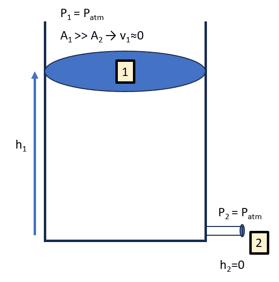

There is a classical example when teaching Bernoulli equations to get the exit velocity of a fluid leaving through the bottom of a tank. If we consider no energy is lost due to friction, the exit velocity turns out to be ##v=\sqrt {2gh}##. I'm having trouble processing the fact that exit speed is independent of nozzle diameter because it contradicts my real-world experience.
Let's assume an ideal scenario where there are no losses in pressure due to friction, water is incompressible and the area of the tank is MUCH greater than the area of exiting pipe. Then, Bernoulli can be applied in the following form.
##P_1+\rho gh_1+\frac{1}{2}\rho v_1^2=P_2+\rho gh_2+\frac{1}{2}\rho v_2^2\rightarrow v_2=\sqrt {2gh_1}##
According to that, no matter the diameter of the nozzle (as long as ##A_1>>A_2## and the time interval considered is not too long) I will get the same exit speed. I would expect that as I reduce the nozzle diameter, the exit speed should increase. At least, that's what my real-world experience tells me.
Am I missing something?

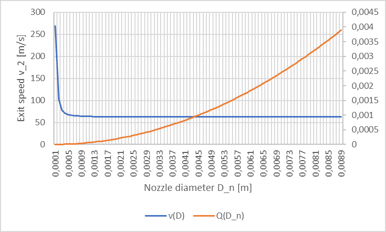

I think I understand the concept of what you're saying. I consider it somewhat counterintuitive because it feels like by introducing more losses at the nozzle we reduce the speed of the flow. Since most of the losses are due to that speed, then the total losses are decreased and we get a greater exit speed.
NOTE AFTER SEEING THE MATH: Although it seemed counterintuitive, I understood it once I realized that even if you get a greater exit speed by blocking the nozzle, the flow is reduced so it doesn't feel like cheating anymore.

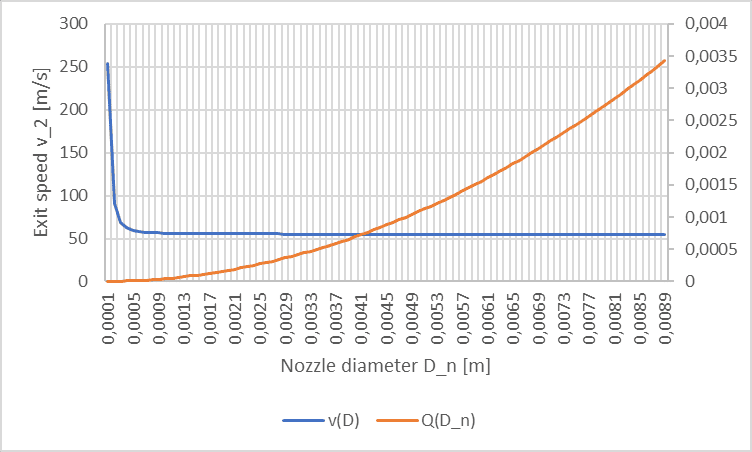

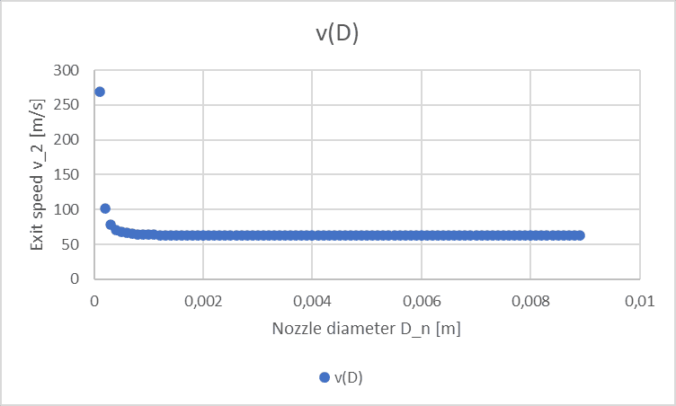

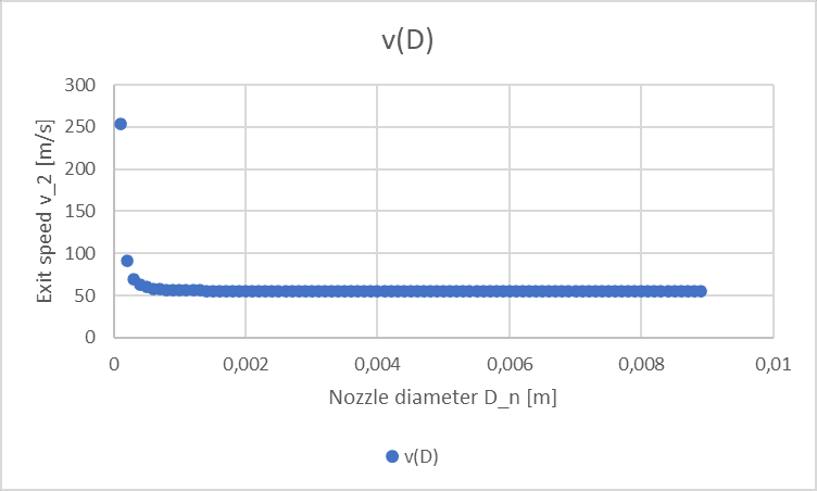

I'll try to express the problem with math to make sure I'm getting it.
Let's then assume a tank again as described in #1. However, now there will be a 100m long hose ##(L)## at the bottom with a 20mm in diameter ##(D_h)##and a nozzle at the end with a different diameter ##D_n##. The water at the tower will be 20m high ##(h_1)##. Fluid is water so I will use ##\rho = 1000 \frac{kg}{m^3}## for the density and for the viscosity ##\mu = 10^{-3} Pa·s##.
Losses at the hose will be ##P_{hose_{loss}}=f_D \frac{\rho Lv^2}{2D_h}##. For simplicity, let's assume laminar flow so ##f_D=\frac{64}{Re}##. Then, the pressure loss at the hose will be ##P_{hose_{loss}}=\frac{32L\mu v}{D_h^2} ##.
Losses at the nozzle will depend on its geometry. As a simplification, I assume it'll be ##P_{nozzle_{loss}}=k \frac{\mu v}{A_n}=k \frac{4 \mu v}{\pi D_n^2}## where ##k=1## and it's there simply to make the units right. That function is not based on experiments. It's just to have something that makes losses in pressure greater as speed increases and smaller as the area increases to have some similarity with the real world but keep the equations simple.
Finally, applying Bernoulli again but taking the losses into account I get:
##P_1+\rho gh_1+\frac{1}{2}\rho v_1^2=P_2+\rho gh_2+\frac{1}{2}\rho v_2^2\ + P_{hose_{loss}} +P_{nozzle_{loss}}##
##{\left \{ P_1=P_2=P_{atm};\ A_1>>A_2 \rightarrow v_1 \approx 0; h_2=0 \right \}}##
##\rho gh_1=\frac{1}{2}\rho v_2^2 + \frac{32L\mu v_2}{D_h^2} + k \frac{4 \mu v_2}{\pi D_n^2} \rightarrow ##
##{\color{Red}\rightarrow{\frac{1}{2}\rho v_2^2 +\left (\frac{32L \mu }{D_h^2} + k \frac{4 \mu }{\pi D_n^2}\right )v_2 - \rho gh_1=0} }##I can then find the exit velocity ##v_2## as a function of the nozzle diameter ##D_n##. Also, the flow will be given by ##\dot{V}=v_2 \frac{\pi D_n^2}{4}##
This time I do get the behavior I am used to from my "real-world experience". As the nozzle diameter decreases, the exit speed increases. As the diameter becomes big enough, the exit velocity is basically constant. For these numbers, it ends up at ~55 m/s because of the loss of pressure in the hose. Also, the flow is always increasing with the nozzle diameter.
If I set the hose length to 0 then the speed approaches ##v_2= \sqrt{2gh} = 62.62 m/s## as the diameter of the nozzle increases.
I think I finally got it. Is there anything I got wrong? Besides all the simplifications I did for the problem regarding the losses in pressure in the hose and in the nozzle.

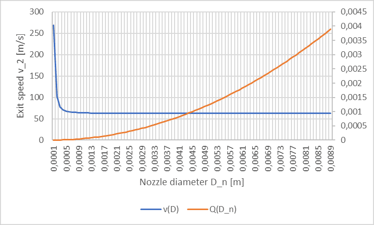

View attachment 328368I think I finally got it. Is there anything I got wrong? Besides all the simplifications I did for the problem regarding the losses in pressure in the hose and in the nozzle.

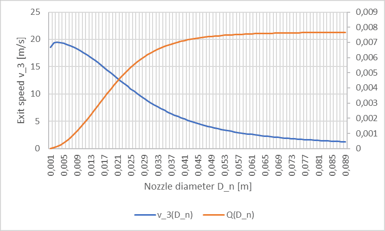

I'm sorry but there are a few mistakes I found after replying.
  1. I didn't use the height for the tank and the length of the pipe I initially established.
  2. I missed a (-) when making the formulas in Excel.
  3. It is necessary to add a 3rd point to the diagram now that I added the hose.
The problem now looks like this.
Using Bernoilli between 1 and 3:
##P_1+\rho gh_1+\frac{1}{2}\rho v_1^2=P_3+\rho gh_3+\frac{1}{2}\rho v_3^2\ + P_{hose_{loss}} +P_{nozzle_{loss}}##
Pressure loss at the hose assuming laminar flow for simplicity:
##P_{hose_{loss}}=f_D \frac{\rho Lv_2^2}{2D_h} \left \{ f_D=\frac{64}{Re} \right \}\rightarrow P_{hose_{loss}}=\frac{32L\mu v_2}{D_h^2}##
Pressure loss at the nozzle according to the function (justification for the function is at #7):
##P_{nozzle_{loss}}=k \frac{\mu v_3}{A_n}=k \frac{4 \mu v_3}{\pi D_n^2}##
##k## is 1 and it's there just to make the units right.
Then, Bernoulli between 1 and 3 will be:
##\rho gh_1=\frac{1}{2}\rho v_3^2\ + \frac{32L\mu v_2}{D_h^2} + k \frac{4 \mu v_3}{\pi D_n^2}##
I need the previous equation in terms of ##v_3## so using mass continuity and incompressible flow:
##Q_2=Q_3 \rightarrow v_2A_2=v_3A_3 \rightarrow v_2 = v_3 \frac{D_n^2}{D_h^2}##
Plugging that into the Bernoulli equation results in:
##\rho gh_1=\frac{1}{2}\rho v_3^2\ + \frac{32L\mu v_3 \frac{D_n^2}{D_h^2}}{D_h^2} + k \frac{4 \mu v_3}{\pi D_n^2}##
##\rho gh_1=\frac{1}{2}\rho v_3^2\ + \frac{32L\mu v_3D_n^2}{D_h^4} + k \frac{4 \mu v_3}{\pi D_n^2}##
I can then plot the exit velocity ##v_3## and volumetric flow ##Q## as a function of ##D_n##.
Using the Internation system, for the values ##\rho = 1000; L=100; \mu=0.001; g=9.8; h_1=20; D_h=0.02## the result is:
It can be seen how reducing the nozzle diameter results in a greater exit speed but it lowers the flow rate.
