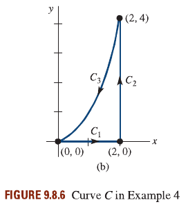

If instead of evaluating the above line integral in counter-clockwise direction, I evaluate it via the clockwise direction, would that change the answer? What if I evaluate ##C_1## and ##C_3## in the counter-clockwise direction, but I evaluate ##C_2## in the clockwise direction?
It sure will. Can you say how it will affect the answer? Think Green's Theorem.
It will be the negative.

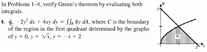

If the direction does matter, in which direction would I evaluate the below line integral?
You would get nonsense.
Actually, it doesn't even make sense to talk about integrating part of a closed path "counter-clockwise" or "clockwise". Where is the center of the "clock face", if you don't have a complete closed path?
I just asked Dr. Martín Argerami. Here is his response:
Direction does not matter for the line integral of a function, but here you are dealing with a work integral (i.e. the integral of a vector field along the curve). In the latter case, orientation does matter.
The statement of Green's Theorem includes (or it should, to make sense) the orientation required for the equality to hold. The orientation for the curve is the one that leaves to region R to your left as you traverse the curve.
Is this right or wrong? It seems to me like the line integral always changes sign when I evaluate in another direction.
ainster, it does always change sign when you evaluate in the opposite direction. For intuition think about one dimensional integrals, and
[tex]\int_{a}^{b} f(x) dx = - \int_{b}^{a} f(x) dx,[/tex]
which is an example of a line integral over a function which is reversed in direction.
