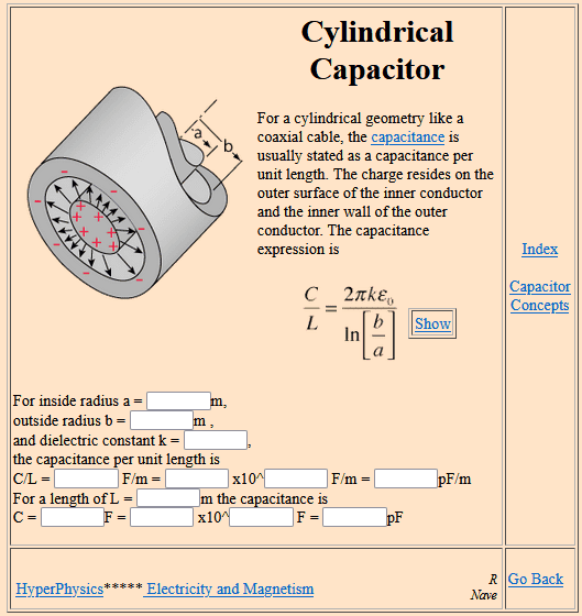

Here's how I can make as many charges as possible accumulate on the surface of the conductor, and not inside? I want the conductor to be completely wrapped on the surface by electric charges, what can I do?
As @Baluncore says, you want to DC charge your conductor, not try to use the AC skin effect. To get a nice circular envelope of charge around your conductor, you can use a geometry like this charged coaxial cable (where the inner conductor has a uniform surface charge:
http://hyperphysics.phy-astr.gsu.edu/hbase/electric/capcyl.html

thanks for the answer, no, the surface is made up of many curves and is not cylindrical, so I think the current can accumulate at the tips. Yes, for the skin effect, a variable current is needed, which produces eddy currents (the real culprits). I'm not a physics expert, so I'm asking you. I would like the body to be wrapped only on the surface (about 1mm, therefore currents with a frequency of KHz) just as happens when you want to transmit with EM waves with an antenna, but I don't have to transmit

I hadn't thought about the similarity with the faces of the capacitor. however by surface currents I mean currents that circulate ONLY on the surface and not at the internal and this is related to the frequency, and increasing the voltage increases the affected volume. Now bodies are not all the same and above all they have many curves, in this case how does the current conduct?
