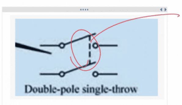

Why does the double pole single throw picture only throw one circuit?
Doesn't it throw two circuits since there are two lines on the right side of the picture?
"throw refers to how many circuits are opened or closed" <- looks like my question hinges on this. Graphically what does it look like for a circuit to be open or closed?
Following the rules for the particular schematic schema, a closed circuit can be traced without lifting the pen.
Where am I tracing my pen?
http://www.allaboutcircuits.com/videos/15.html
So double poel single throw has evidently 1 circuit opened or closed during operation. So why aren't there 2 circuits?
There are two circuits. I don't understand why you think there is only one shown?

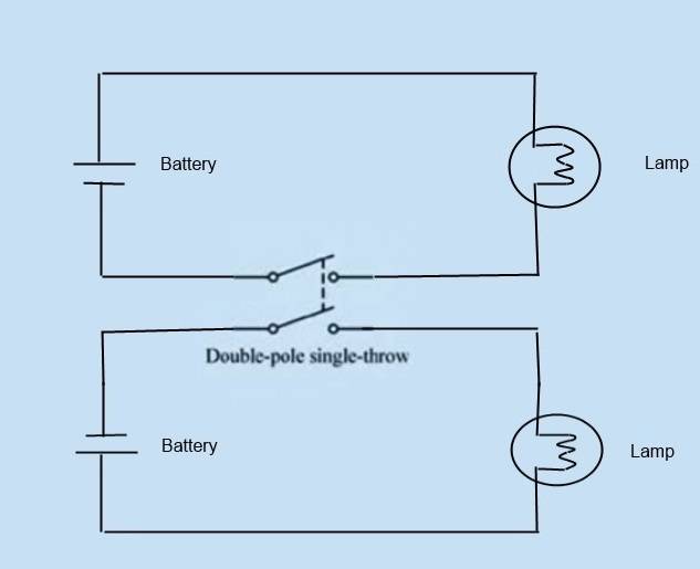

Here is an example showing how a DPST can control two electrically separate circuits...
Both poles are mechanically linked so if one switch is ON they are both ON. They are shown in the OFF position (aka "open circuit").

Why is this single throw
So if the above picture is single throw then there should be one circuit opened or closed. Aren't there two?
It is Single Throw because both switches are mechanically linked (as has been said several times already). When you close the switches, they both close at the same time. The upper pole closes the circuit for the upper pair of contacts, and the lower pole closes the circuit connected to the lower terminals.

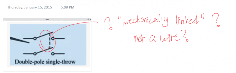

" Both poles are mechanically linked so if one switch is ON they are both ON. They are shown in the OFF position (aka "open circuit")."
Is it the dotted line here that means mechanically linked?
Yep, that's what that dotted line means. :-)

If it were a wire it would be drawn as a continuous line, like all other wires. Sometimes it helps if one tries to come to terms with a system instead of just complaining about it. The examples quoted in this thread are comprehensive enough to give a clue about the system. There are many examples of circuit diagrams all over the web. A few minutes looking at a sample would be more useful than a good winge on PF, imo.
BTW, what would be the point of designing such a switch if it worked as you seem to think it does? Two input wires, joined together? Whatever for?

Might also help if I redraw it like this..
The two switches are usually physically close together but could be any physical distance apart. There is no electrical connection between AB and AD.
