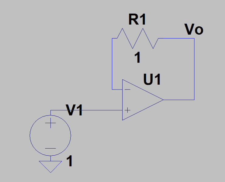

Hi,
Here is what I know about the Ideal Op-Amp.
- The open loop voltage gain is infinite
- The output voltage is given by the following $$v_o = A(v_+ - v_-)$$
- Only with a negative feedback loop is $$ v_+ = v_-$$
My query is with regards to the negative feedback loop as shown below:
My queries are as follows:
1. Clearly, $$v_o = A(v_+ - v_-)$$ should still apply and since $$ v_+ = v_-$$, shouldn't the output voltage $$ v_o = 0 $$ always?
2. Since $$v_o = A(v_+ - v_-)$$ should still apply, is A still the open-loop voltage gain which for an ideal op-amp is infinity. Thus, would the output voltage always be infinity?

Post a typical opamp configuration so we can talk you through this. The output current flows back through the feedback circuit through the virtual ground node at the - input. There is a voltage drop from the output of the opamp to the - input. :smile:
Okay, I've adjusted my question. Now, after some googling I found this
from here
https://ocw.mit.edu/courses/electri...ent-spring-2006/lecture-notes/22_op_amps1.pdf
And that indicates to me that Vi = 0 which means that V+ = V- always not just for negative feedback? I'm so confused. The more I google, the more confused i get.

So basically, I've managed to understand most of it I think now but I have one question. Clearly from this argument,
The differential input voltage is zero and thus inverting and non-inverting voltages should be equal. Why do people then say that only in a closed loop configuration(with negative feedback) is the differential input voltage zero?
Because this simply is the RESULT of negative feedback - applied to an amplifier having IDEAL properties (infinite open-loop gain Aol.)
For each real amplifier (finite Aol) we have a finite Vdiff=Vout/Aol.
For a better understanding (WHY and HOW this happens) you must study in detail the various effects and the benefits of negative feedback.
In order for the difference to be zero the op amp gain has to be inf.
Remember that the output is always equal to the difference between the two inputs times the op amp open loop gain, like you already said.Take the attached circuit. There is a constant input voltage of V+=1.
We know that there is no current through the resistor in an ideal op amp.
So V- = Vo
We also know Vdiff = (V+) - (V-)
and Vo = Vdiff * Ao
For each gain setting there is an equilibrium state where V- and Vo must be equal to each other. It's like solving a system of equations, there is only one possible solution that exists, the voltages are driven to a set value.
Lets look at how the output (and therefore v-) changes with open loop gain.
remember v+ = 1
Ao = 1: Vo = V- = 0.5. This means the difference between V- and V+ is 0.5
Ao = 2: Vo = V- = 0.6666. This means the difference between V- and V+ is 0.3333
Ao = 10: Vo = V- = 0.909. This means the difference between V- and V+ is 0.091
Ao = 100: Vo = V- = 0.99. This means the difference between V- and V+ is 0.001
Ao = 10000: Vo = V- = 0.9999. This means the difference between V- and V+ is 0.0001
This continues as Ao increases. Once Ao gets high enough, the difference is for all practical purposes 0, which is why these op amps are designed to have very high gains, and why an ideal op amp has a gain of inf.
