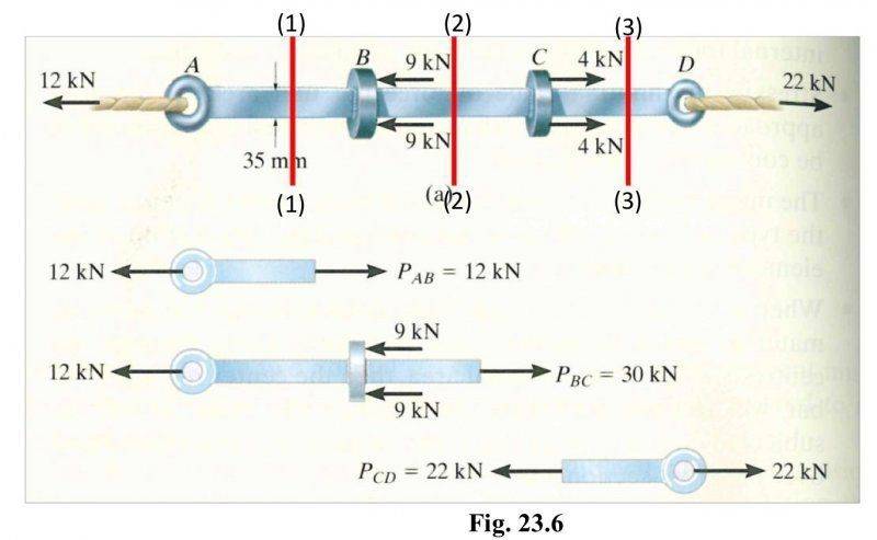

Shouldn't it be Pdc = 22kN rather than Pcd? I mean the 22kN force arrow is pointing towards C? Because Pdc means the P from D to C no?
The discussion clarifies the correct notation for forces in a free body diagram (FBD) involving points D and C. The force should be denoted as Pdc = 22kN, indicating the force exerted from D to C, rather than Pcd, which would imply the force from C to D. The participants emphasize the importance of accurately representing forces in FBDs and suggest using Newton's Third Law to validate the notation. This distinction is crucial for proper analysis in structural engineering contexts.
Engineering students, structural analysts, and professionals involved in mechanics or force analysis will benefit from this discussion.
influx said:View attachment 81257Pcd is the force of c on d. Pdc is the force of d on c. Free body diagram of cut section 3-3 to D is shown. You can draw FBD of cut section 3-3 to A to get Pdc. Or use Newton 3.
