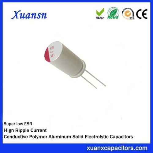

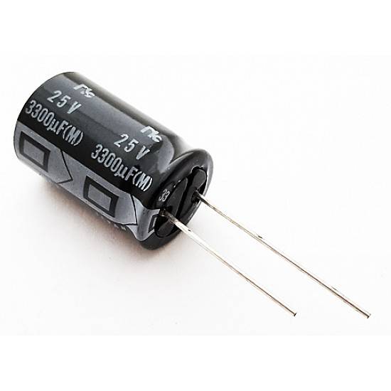

Solid or non-solid electrolyte ? You picture both types in post #1.
You must read the manufacturer's recommendations and data sheet for storage and ageing information.
My devices have both types
