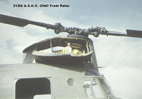

We'll, we are answering his question. In principle, it would be better to have to rotors on the bottom. This is exactly why the Chinook has the front rotor at a lower elevation that the aft rotor. This way, the air entering the rear rotor is realtively unaffected by the downwash of the front rotor.

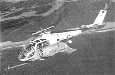

Example of a compound helicopter:

You would, undoubtedly, have to increase the rotor disc size because you would block a larger area towards the center of the hub. That in itself would be a design killer since tip speed for rotors dominates a design.
