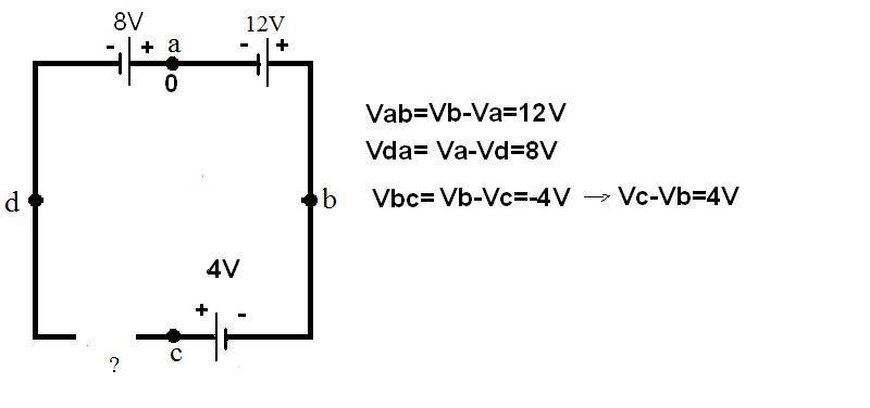

Consider a circuit containing four nodes
labeled a, b, c, and d. Also, we know that
vab= 12V,vcb=−4V,and vda= 8V. Deter-
mine the values of vac and vcd. (Hint: Draw
a picture showing the nodes and the known
voltages.)
∑ voltages in a loop = 0
I had no idea how to approach the problem, just a couple ideas. I tried sketching this out:
Circuit diagram with four nodes a, b, c, d on a rectangle: 8V element between d and a, 12V element between a and b, -4V element between c and b, unlabeled element between d and c, and a central element between a and b-side branch marked with a question mark, plus a question-marked element on the bottom-left branch.
This one didn't make much sense to me since applying the loop rule, I get differing answers for ##v_{ac}##
So I tried a few other ways to draw it and this was the closest I could get:
Circuit diagram with nodes a, b, c and d: a resistor labeled -8V between a and d, a 12V element and a -4V element in series on the right between a, b and c, a resistor labeled ? between c and d, and another resistor labeled ? on the left side of the outer loop.
This seems like it makes more sense, but I'm not entirely sure. Am I on the right track?
I recommend the first thing to change is you need to change your voltage symbol to indicate some sort of polarity. They blue squares alone are not sufficient. Either use a symbol with obvious polarity such as a battery symbol, or (and this is just as good too) label the '+' and '-' signs.
What I mean by that is if you look at the 8 V element in the upper left. Imagine, hypothetically, flipping the polarity of that element, making it VAD = 8 V. If you did so, it wouldn't look any different than the way it is now with VDA = 8 V. You need some way of indicating the polarity. You need to know by looking at your picture that if VDA = 8 V, then VAD = -8 V
Secondly, don't draw that stuff in the middle. It's not necessary. Just keep it as a square if you wish (or even three sides of a square), with nothing in the center. Note that VAC = VAB + VBC
It is easier to work with potentials. If Vab means the potential of b with respect to a : Vab=Vb-Va=12 V. Write 0 at point a and 12 V at point b. Draw a battery between the nodes to ensure the given potential difference.
Draw the batteries and determine the potential of each node. Calculate the potential differences Vac=Vc-Va and Vcd=Vd-Vc.
You can connect a resistor between two nodes and an other one between the other two nodes, the potential differences would not change.
ehild
  • Circuit loop with four nodes a, b, c and d: an 8V battery and a 12V battery on the top wire, a 4V battery at the bottom, with handwritten potential relations Vab=12V, Vda=8V, Vbc=-4V and a question mark on the bottom gap.
