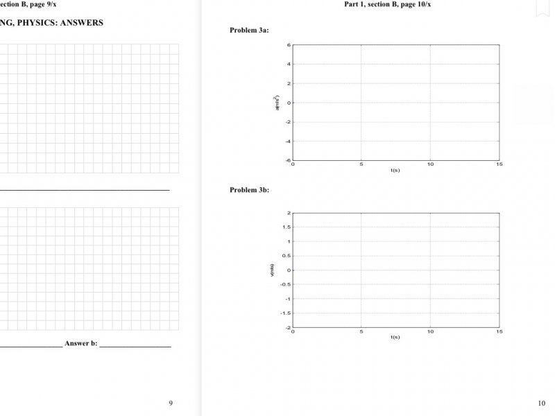

oh yes, Thank a lot. I just think crazy out of a box when velocity was too high than the graph expected to be drawn.
I attached the area for the graphs.
they would draw the wrong coordinate for velocity
Like I said - just relabel the axes after checking that you have read the question correctly.
The top one (that goes to 6) looks like it has the correct range for the v(t) graph and the bottom one looks correct for a(t)... so maybe they just got them switched.
yes, I got it. thank so much for your help Simo
