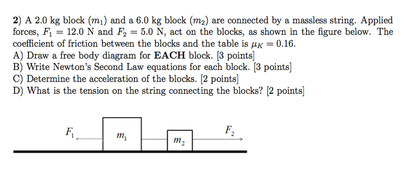

I've attached a screen shot of the problem. It is from last year's Physics Final. I was pretty confused by the problem, it is stated that the coefficient of friction is μk. Therefore, I am definitely sure the system is accelerating. Maybe I described the problem incorrectly, I hope the picture helps! Thank you.
The description was good, but as described, it can not be accelerating. Instead of looking at FBD's of each block, try looking at an FBD of both blocks together, that is, look at a FBD of the entire system as a whole. In this manner, you don't have to consider the tension force in the cable connecting the blocks, since it is internal to the system. Thus, the external forces acting are the applied forces F1 and F2, and the friction forces between the blocks and table. Then using Newton's 2nd Law,
[itex]F_{net} = (m_1 + m_2)a[/itex]
[itex]F_{applied} - F_{friction} = (m_1+m_2)a[/itex]
[itex]12 - 5 - F_{friction} = 8a[/itex]
[itex]7 - F_{friction} = 8a[/itex]
Now if the objects are accelerating, then a must be greater than than 0, and less than 7/8, which means the total friction force must be less than 7. But since uk(N) = .16(80) = about 12 or so, that means the system is at rest. The actual friction force is static and less than us(N).
You should note that the picture shows, by scaling, m1 bigger in size than m2, and also F2 greater than F1, in contradiction to the description. Something went wrong when developing the OP. Everyone, including yours truly, makes errors, but it is a bit disconcerting when presented as a final exam question. They probably tossed it out when grading.
