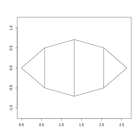

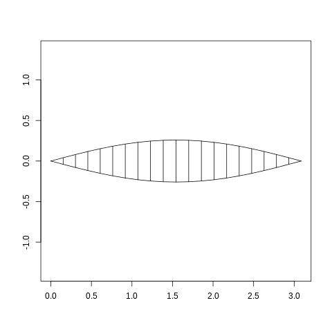

I ultimately want to make a sewing pattern of a ball. If I have an n-hosohedra, how do I figure out the equation of the curves that make up each lune in 2D?
Assuming you are using ordinary, flat material, your lunes will need to be quite thin because they will have a flat geometry that differs from the curved geometry of a proper lune. The thinner the lune, the less that will be a practical problem. Using material that is a bit stretchy can also help make it less of a problem.
I would make a flat approximation of a thin lune of a n-hosohedron (for n large, say at least 18) by choosing a fairly large m (say > 100) and defining each approximate lune as consisting of 2m segments in sequence, starting with a triangle, (m-1) gradually fattening trapezia to get to the equator, then another (m-1) thinning trapezia and ending with another small triangle. Each segment has left-right symmetry, eg the triangles are isosceles.
The k-th segment (counting away from the pole with the triangle as segment 1) will have its top in the plane ##P_{k-1}## parallel to the equatorial plane with latitude (k-1) * pi / 2m and its base in the plane ##P_{k}## parallel to the equatorial plane with latitude k * pi / 2m.
The height of each segment is equal to one side of a regular 4m-sided polygon.
The base of the k-th segment is the same length as one side of a regular n-sided polygon with radius (distance from centre to any vertex) equal to the radius of the cross section of the sphere that lies in plane ##P_{k}##.
From that specification you can plot a flat shape of a lune to use as a stencil using ordinary Euclidean geometry.

No, that's not right - the point I think we are missing is that the length of the curved edge must be the semi-circumference of the sphere, not the centre of the piece (which is going to need to stretch). This makes it harder...
Smed said:

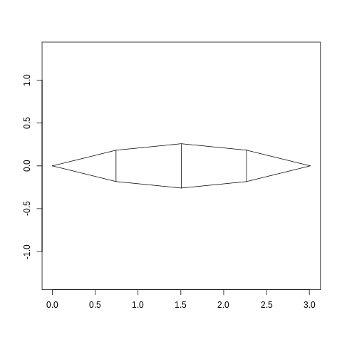

I'm having a bit of difficulty following how each trapezoid will change its shape as you approach the equator.

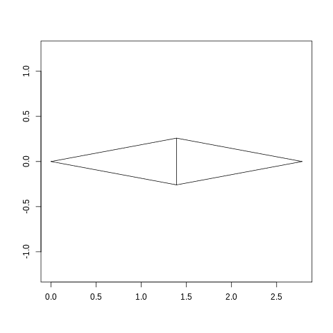

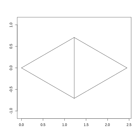

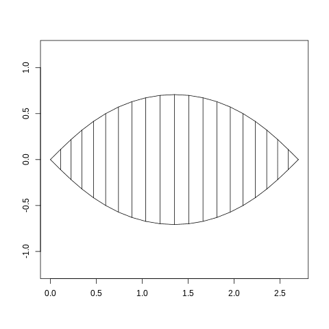

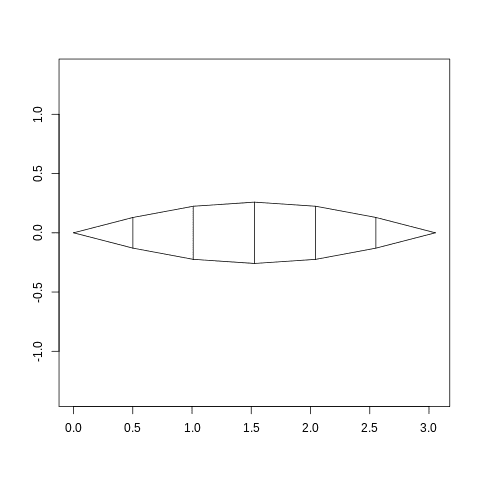

Here are pictures to help, made to scale. In the filenames the first number is the number of lunes and the second is the number of segments in each hemisphere of a lune (so each lune has twice that number of segments). In case the file names aren't visible, the diagrams are for a four-lune and a twelve-lune ball. In each case, a lune is shown with 1, 2, 3 and 10 polygonal segments in each hemisphere. The 10-segment lune looks indistinguishable from a smooth curve, to my fuzzy eyes at least!
My partner, who is an expert at sewing, says you could use a machine to join two lunes by putting two lunes back to back and sewing through the aligned edge at one side. It'll get progressively more tricky as the number of lunes you have sewn together increases. I expect the last few would have to be done by hand. She said that English paper-piecing would make the edges neater.
Each lune cut-out would have extrinsic but not intrinsic curvature, because it is cut from flat fabric. That means the lune fabric would need to stretch a bit to match the intrinsic curvature of its segment of the sphere. But if you have quite a few lunes (say at least twelve) the curvature should be small enough to not be a problem.
By the way, lunes like in the first diagram lune.4.1 would make an octahedron - one of the five platonic solids - although this octahedron is not regular (correction: after fixing an error in the horizontal scale, it is regular).
No, that's not right. In order to get as smooth a 3D shape as possible, there are two important things to get exactly right:
  • the angles at the top of the pieces must add up to 360°
  • there must be no angle at the mid point
These are much more important than the precise profile of the curve between these points.
andrewkirk said:
By the way, lunes like in the first diagram lune.4.1 would make an octahedron - one of the five platonic solids - although this octahedron is not regular.
This should give you a clue that your pieces are too high - obviously a regular octahedron would be a better approximation to a sphere.

Naturally the case with four lunes, each of only two segments - the octahedron - is a poor approximation. Nobody would suggest using only four lunes, or only two segments. The purpose of including those drawings was to demonstrate how quickly the approximation improves as we increase the number of segments, and also because it makes it easier to conceptualise the shape of the segments.
pbuk said:
your pieces are too high ... a regular octahedron would be a better approximation to a sphere.
That's an excellent observation. It made me realize I got the horizontal scale wrong in the diagrams. The shape is indeed a regular octahedron. I've redone the diagrams with the scale corrected, and replaced the ones in my post above.
In drawing the diagrams I used the following equation for the distance to the lune outline from its centre line:
$$r \cos \theta\sin(\pi/n)$$
where ##\theta## is the elevation of the point above the equatorial plane and n is the number of lunes. That is half the length of an edge of the regular n-gon inscribed in the latitudinal circle at latitude ##\theta##.
The shape, for high m (number of segments per lune) is very close to the convex hull of n evenly spaced longitudinal great circles. It's what we'd get if we made a wire ball out of n evenly spaced longitudinal great circles and covered it in cling wrap. As n goes to infinity, that shape approximates a sphere.
More generally, the shape for any n and m is the convex hull of points on the surface of a sphere at the intersections of latitudinal lines of which there are m-1 in each hemisphere, excluding the equator, and n evenly spaced longitudinal lines (meridians). It's what we'd get if we made a spiky ball of radial wires going from the centre of a sphere to those points, and covered it with cling wrap that was strong enough not to be pierced by the ends of the wires. The shape is a polyhedron, so the surface is flat everywhere except at edges and vertices (which is required as we are using flat fabric) and it is easy to see that it approximates a sphere as n and m go to infinity.
I attach the R code used to produce the plots, for anybody that is interested.

andrewkirk said:
We cannot get anything exactly right, because we are using flat fabric pieces to approximate a surface that is nowhere flat.
I am talking about the 2d curve of the edge of the fabric, not the 3d shape the piece adopts when stretched.
andrewkirk said:
But we can approximate the shape. The higher the values we take for the two parameters I specified in my first post, the closer the approximation will be. The limit of the angle sum at the pole, as both n and m approach infinity, will be 360 degrees.
Agreed, in the limit you have specified (almost) the right curve.

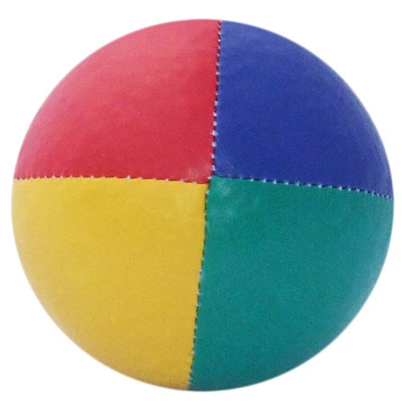

I'm afraid four-lune balls are very common as I wrote in #3; here is a picture of one:
Source: https://www.jacjuggling.co.uk/jac-products-thud-juggling-ball-180g-1439-p.asp.
These balls are nearly perfect spheres and this is achieved by having the top of the pieces tangent to an angle of exactly 90° and the equator exactly smooth.
