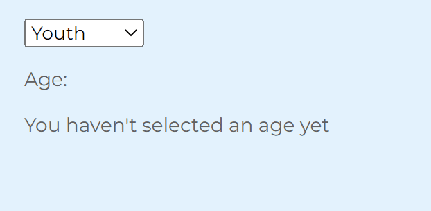

I tried to run this code to understand that better but I get a white page in the browser. Why? 🤔
So we define const renderSwitch = (age) with parameter age and it depends on the user's input in which case we are and the corresponding message appears, right?
What exactly does const [age, setAge] = React.useState(null); and const handleChange = (event) ?
Then at the return we have the part where the user selects one of the given options, right?
And then we call renderSwitch = (age) with parameter the user's answer to show the corresponding message.
Have I understood correctly the idea? 🤔
You don't need the
JavaScript:
const root = ReactDOM.createRoot(document.getElementById("root"));
root.render(<GTMSourceNew />);
code at the end, just replace the whole of the definition of GTMSourceNew in your code with mine.

What exactly does const [age, setAge] = React.useState(null); [do]
It creates a special reactive state variable called `age` and a function that you can use to mutate its value: calling `setAge(20)` will set the value of `age` to 20 and trigger all of its observers so that they automatically update.
Again this is an arrow function.
JavaScript:
  const handleChange = (event) => {
    setAge(+event.target.value);
is almost the same as (and here could be replaced by)
JavaScript:
  function handleChange(event) {
You had used this type of function definition, and useState, in #5 so I assumed you were OK with these.
Not exactly, the point is that the reactive age variable could be changed by something other than what the user selects - for instance it is set initially to `null` by the initial call to `useState`. Remember: a change initiated by the user never changes what is rendered directly, user input mutates state and observers react to the change in state.
pbuk said:
You don't need the
JavaScript:
Now it runs but when I select one of the options the renderSwitch(age) doesn't seem to work since it doesn't appear anything. Shouldn't the corresponding message appear when we select one of the options?
It appears just :
As I understand it doesn't recognize "age", I mean the variable "age" has no value. But why? 🤔
Either
  • `age` has stopped being a reactive variable (this can happen if you forget to use setAge() and just write a value to age) or was not one in the first place
  • the onchange handler is not being called - check this by putting
    JavaScript:
    console.log('Hander', age);
    at the end of handleChange: age should be an object not just an integer
  • the onchange handler is not setting the value properly - check this by changing
    JavaScript:
    // to
    setAge(10);
  • the components are not reacting properly (unlikely: there's not much that can go wrong with <p>Age: {age}</p> as long as {age} is reactive).
I had an error, I corrected it and now it works properly! Thank you very much! :smile:

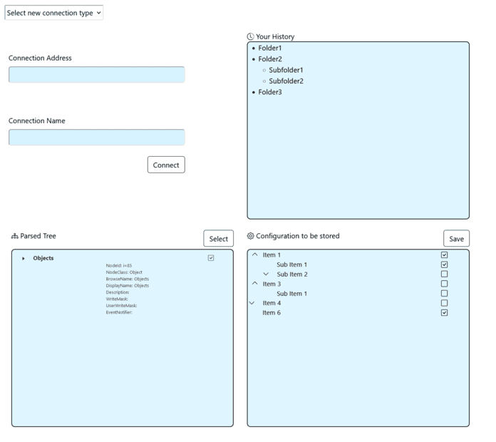

I want to do something like the following :
So this means two Grid parts and in each Grid two Items, right?
Would this mean then the code to be as follows ?

I'd do it like this:
HTML:
<Grid container spacing={2}>
  <Grid item xs={12} md={6}>
    Connection content here.
  </Grid>
    History content here.
  </Grid>
    Parsed tree content here.
  </Grid>
    Configuration here.
  </Grid>
</Grid>
Note this would display in two columns when the display window is at least 900px wide: for 2 columns on 600+px wide screens replace all md={6} with sm={6}.

Ah ok! But when we would this example in an other way for example only the first container in the first row and all the other three in the second row would we change xs and md so that the first fits exactly in the sreen and the other dividing into 3 parts? 🤔
Then we would do the following :

mathmari said:
These large boxes are input fields?
For example :
JavaScript:
<label>
    Your History <br></br>
    <input type="text" name="history" />
</label>
Or what type are these?
The term "container" applies to the outermost element - here we have one container which wraps four items.
Your markup for a layout like this is close, but note that there are 12 columns so for 3 items in a row you want each to be 4 wide:

At the first one we don't need md, right?Now I saw that just the Connection is an input field, the other ones are just boxes with a content. Do we define such boxes with <Box>...</Box> ? Or do we just itemize the data ? 🤔
Do we maybe do something like the following ? 🤔

mathmari said:
Now I saw that just the Connection is an input field, the other ones are just boxes with a content. Do we define such boxes with <Box>...</Box> ? 🤔
I'd probably do something like
HTML:
    <Grid container>
    <Grid item xs={12} sm={6}>
      <Toolbar style={{ background: '#eee' }}>
        <IconButton
          size="large"
          edge="start"
          color="inherit"
        ><SettingsIcon /></IconButton>
        <Typography variant="h6" sx={{ flexGrow: 1 }}>
          Configuration
        </Typography>
        <Button color="inherit">Save</Button>
      </Toolbar>
      <Box pt={2}>
        Display the configuration here.
      </Box>
    </Grid>
  </Grid>
