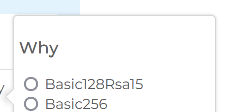

I wrote now the following :
JavaScript:
<input type="radio" id="No" value="No" name="answer" /> No
      <Popup
         trigger={
            <label>
              <input
                  type="radio"
                  id="Yes"
                  value="Yes"
                  name="answer"
                  style={{
                      marginLeft: '55%'
               Yes
            </label>
        position="right center"
        <div>
           <h3>Why</h3>
               <label>
                  <input type="radio" value="reason1" name="reason" />Reason1
                  <br></br>
                  <input type="radio" value="reason2" name="settings" /> Reason2
               </label>
       </div>
Now I get a popup of the form :

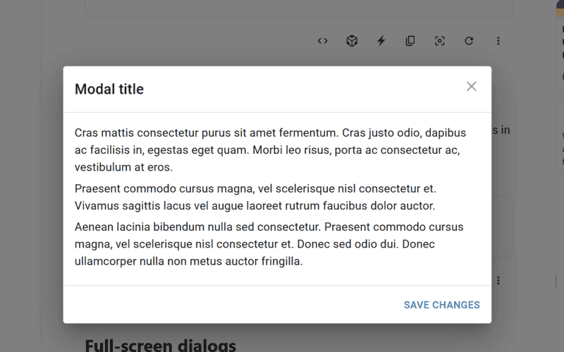

Could we style it do get a popup of the form :

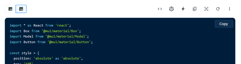

No, that's not a popup, it's a (modal) Dialog: https://mui.com/material-ui/react-dialog/
Different animal.
Likes mathmari
pbuk said:
No, that's not a popular, it's a (modal) Dialog: https://mui.com/material-ui/react-dialog/
Different animal.
I have already tried the version of the link you sent but I get an error message that it must be typescript instead of javascript. 🤔
What exactly is the message?
Have you noticed there are now 2 versions of the boilerplate scripts on the MUI documentation site - you switch between them with the buttons at the top left of the box: the image below shows Typescript select (by default). If you do not have a TS transpiler in your build chain you will need to select the JS version.
Likes mathmari
Ah ok! And then when we want to call it we define <FormDialog /> ? 🤔

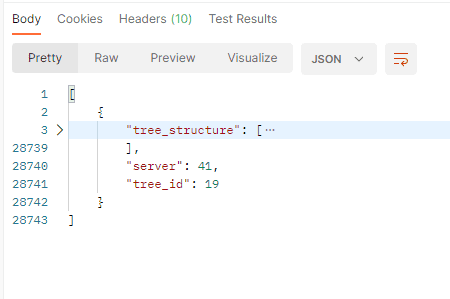

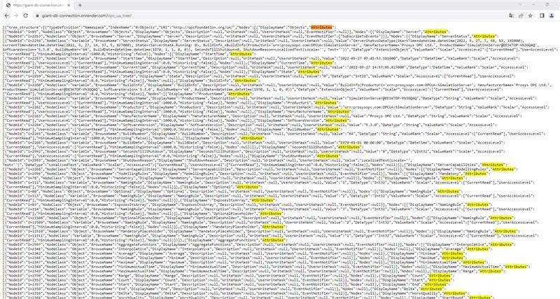

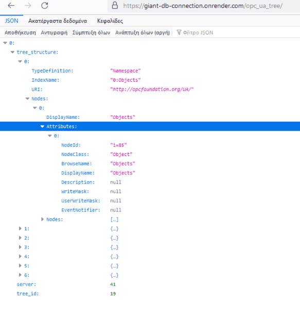

Ah ok! To call this POST request we go click on a button and with onClick we call then the above function, right?
What happens with a GET request? Then we don't click on a button, we just want that something is shown up, right? Do we just call then the function?
Is the GET request as follows when we want that just the Attributes are shown, as you see in the belox picture?
JavaScript:
const [parsed_tree, setParsedTree] = useState('');
    useEffect(() => {
        ParsedTree();
    const ParsedTree = () => {
        axios
            .get(`https://giant-db-connection.onrender.com/opc_ua_tree`)
            .then((res) => ((attributes = res.data.tree_structure.Nodes.Attributes), setParsedTree(attributes)))
            .catch((error) => console.error(error));
Or in JSON format :
I have changed this and I think the way I get the attributes is now correct :
JavaScript:
    useEffect(() => {
        ParsedTree();
        axios
            .then(
                (res) => (console.log((attributes = res.data[0]['tree_structure'][0]['Nodes'][0]['Attributes'])), setParsedTree(attributes))
The point where I got stuck right now is how to display the attributes. Do we do that with .map ? 🤔

I had tried the following :
JavaScript:
   const [dataObj, setDataObj] = useState([]);
   useEffect(() => {
        fetch('https://giant-db-connection.onrender.com/opc_ua_tree/')
            .then((res) => res.json())
            .then((data) => {
                setDataObj(data[0]['tree_structure'][0].Nodes[0]);
                console.log(dataObj.DisplayName);
                while (dataObj.Nodes) {
                    for (let i = 0; i < dataObj.Nodes.length; i++) {
                        console.log(dataObj.Nodes[i].DisplayName);
                    setDataObj(dataObj.Nodes);
I want to display all the DisplayNames. First I did it with many for loops and it worked, now I am trying to write it with less code by setting dataObj.Nodes into the current dataObj. Is this correct so far?
Can the result be also in a TreeView (TreeItem) ? 🤔
