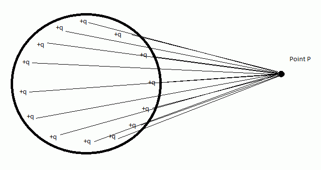

So if I have a sphere of uniform charge distribution, the electric field at one point away from the circle would be affected by ALL individual charges distributed across the circle, right?
From the picture I drew, there would only be a net effect of E-field in the X direction because there would be equal opposing forces in the Y-direction as well as Z-direction, right?
If I added up all the electric fields in the X-direction at that point using Coulomb's law for each point charge on the sphere, would it also match the E-field calculated from Gauss's Law?
I've drawn a top-down picture here: https://imgur.com/a/kAQjS

there we go :wink:
is the sphere hollow or solid ?
Is point P a charge or are you just wanting to know what the E-field is at that point ?
for a Gaussian hollow sphere have you come across this in your studies ? ...
Yes
Yes, so long as the center of the sphere and point p are both on the x axis.
yes, this is a result of Newton's shell theorem https://en.wikipedia.org/wiki/Shell_theorem.
