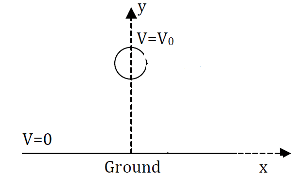

Find the electric field between the conductor and ground. The conductor is at:
  • Potential = +V0,
  • radius a
  • distance d from the ground plane.
I used image theory to create a conductor at -V0 at distance -d from the ground plane.
Laplace's equation: ∇2V = 0
My main road block on this problem is that the cylindrical conductor is NOT at the origin. This means the symmetry in φ and z do not apply, and I cannot easily solve Laplace's equation since V = V(r,φ,z) instead of V = V(r) for a cylinder at the origin. Note that I am in second year electrical engineering, so I don't think we are supposed to solve PDEs... Also, if I set my positive charged conductor at the origin, then my image conductor is still not symmetric with respect to φ and z, and I face the same concern.
Can someone give me a hint on what to do when the conductor is not centered at the origin? Right now, I have the ground plane set as the y = 0 plane and the conductor lying on x = 0.
Thanks a lot!

Hi BvU, thanks for the reply!
You're correct about the ground plane being a conductor at zero potential. The problem setup is shown in the picture below:
The cylinder and ground can both be considered to be infinitely long.
I just need the Electric field on the y-axis between the cylinder and ground. Can that simplify my calculations somewhere?
Aha! so I can use the pile of scratch paper I reserved for the whole exercise for something else ! Good for me and for the environment :wink: !
Infinitely long means the end effects aren't there and this is a 2d problem (from mirror symmetry wrt the xy plane there's no z component). Phew !
And you only need the field on the y-axis. Piece of cake.
The whole mirror charge thingy is based on the uniqueness of solutions to the Laplace equation. Find one, then that's it!
Mirror disk with charge -q at -d is good.
The problem statement still is incomplete to me :confused: : we don't have something for the radius or the diameter, and somehow I don't think I can hope that it's zero :frown: .
But if it is, we're done.
If it isn't zero, then we can still have the bright idea that for small r/d a (2d) dipole field is a good step towards the solution. Turns out to be the way to go.
Check out the shape of the equipotential planes for two parallel line charges !
