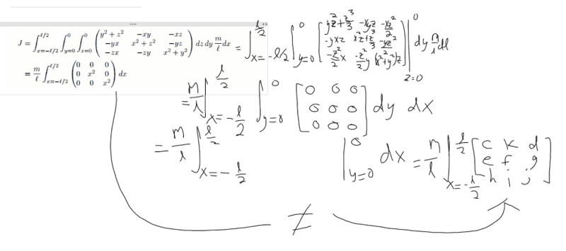

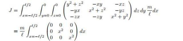

This is just the triple integral of an easy matrix problem. I just have no ideas what they got by the time they got to the integral of x.
integral[/B]
Somebody please prove me wrong. I got a matrix of constants by the time I got to x, not this
Typeset equations: J equals a triple integral over x, y and z of a 3x3 matrix with entries y^2+z^2, -xy, -xz, -yx, x^2+z^2, -yz, -zx, -zy, x^2+y^2, times dz dy (m/l) dx; below, equals (m/l) times the integral over x from -l/2 to l/2 of the diagonal matrix with entries 0, x^2, x^2 times dx.

Handwritten working over a typed inertia tensor integral, with a long curved arrow from the typed part to the handwritten part and a not-equal sign between them; the handwritten side has matrices and integrals in x, y and z limits.
  • Handwritten working over a typed inertia tensor integral, with a long curved arrow from the typed part to the handwritten part and a not-equal sign between them; the handwritten side has matrices and integrals in x, y and z limits.
Clearly the integral is zero. The integration domain has measure zero. I suspect what was intended was to integrate some delta functions over a non-empty domain.

This is a little unusual. I think that the answer is the zero matrix. The reason is that even the elements that do not include y or z would integrate to 0 when the integral ends are both 0. In fact any time both ends are the same. Suppose the antiderivative of function f is F. Then ∫a af(y) dy = F(y)|y=a - F(y)|y=a = F(a)-F(a) = 0

This is clearly the case. I suspect the integral has been malconstructed. It seems to be the computation of the moment of inertia tensor for a slender rod, except the density function should be a delta function in y and z, not a finite one. As it stands, the dimensions are even wrong.

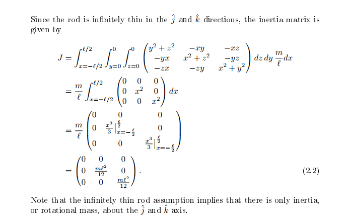

Typeset derivation of the inertia matrix J as a sum over particles and as an integral over a rigid body, ending in the matrix with entries y^2+z^2, -xy, -xz, -yx, x^2+z^2, -yz, -zx, -zy, x^2+y^2 integrated over the body.

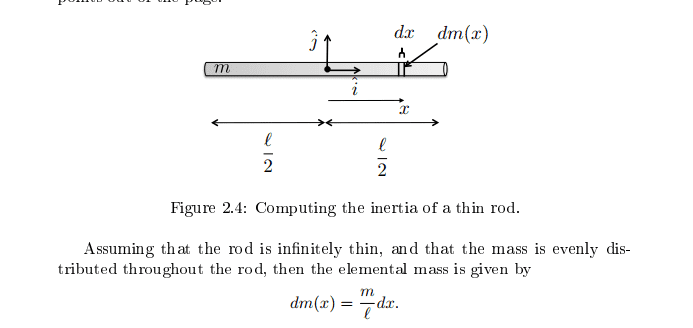

Diagram of a thin rod of mass m and length l, with a unit vector i-hat along its length from the centre, an element of length dx at position x labelled dm(x), and half-length markers l/2 on each side.
Typeset derivation of the inertia matrix J for a thin rod of length l and mass m, integrating over x, y and z, reducing to a diagonal matrix with entries m l squared over 12 in the second and third positions (equation 2.2).
  • Diagram of a thin rod of mass m and length l, with a unit vector i-hat along its length from the centre, an element of length dx at position x labelled dm(x), and half-length markers l/2 on each side.
  • Typeset derivation of the inertia matrix J as a sum over particles and as an integral over a rigid body, ending in the matrix with entries y^2+z^2, -xy, -xz, -yx, x^2+z^2, -yz, -zx, -zy, x^2+y^2 integrated over the body.
  • Typeset derivation of the inertia matrix J for a thin rod of length l and mass m, integrating over x, y and z, reducing to a diagonal matrix with entries m l squared over 12 in the second and third positions (equation 2.2).

I suggest that you think about what dm is in terms of the coordinates. In general, it is given by ##dm = \rho \, dV## and you should integrate over all of space. (There are several hints in my previous posts.)

For example, if you would try to compute the mass in a similar way, you would get zero.
One way around using delta functions is to skip the y and z integrations altogether and write ##dm = \rho_\ell dx##, where ##\rho_\ell## is the linear density (mass per length). The y and z coordinates are always zero.

You could integrate from ##y=-\infty## to ##y=\infty##. It actually doesn't really matter what interval you use as long as it contains ##y=0## because the delta function is zero except when ##y=0##, where the rod lies. Same with ##z##.
The author of the book was extraordinarily sloppy. There are often cases where you write mathematics down which isn't rigorously correct but which gets the job done, but the integral you're dealing with is just plain wrong. It's no surprise it confused you.
