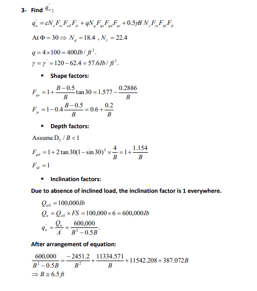

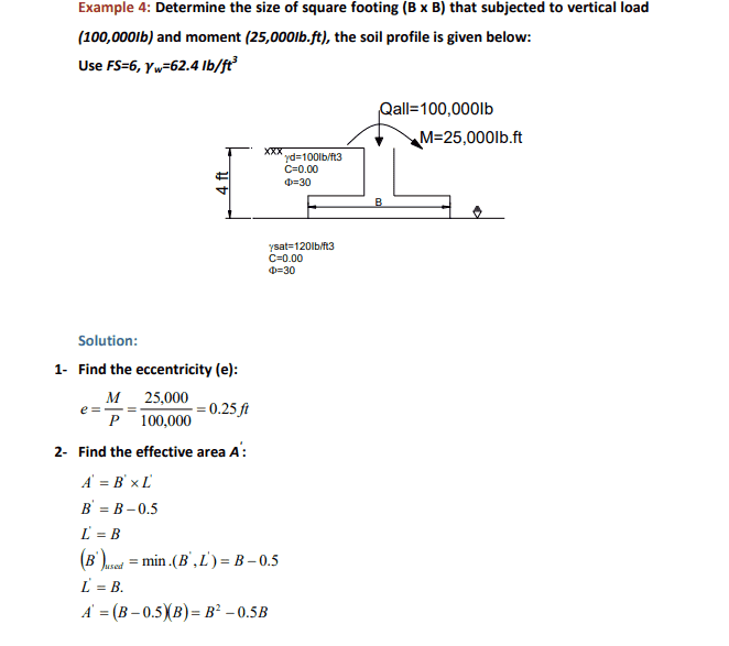

For this question , I tried to use L' = L -2e and B '= B , i ended up getting different final answer when i use L ' = L , B'= B -2e
In the notes , we can see that if the eccentricity were in the direction of length of the foundation , L '= L-2e , and B'= B ...
But , in this question , I am not sure whether the eccentricity were in the direction of length of the foundation or the width of foundation
Why can't I use L' = L -2e = L-2(0.25) = and B '= B to determine the answer. Since this question is a square foundation , I'm confused whether to use L' = L -2e = L-2(0.25) = and B '= B or L ' = L , B'= B -2e ... Can anyone explain please ?

I think this goes back to the definitions of B and B'.
B and B' are always the shorter lengths of the plan dimensions of the foundation.
So, although you compute L'= L - 2e, L' will now be smaller than B'=B=L. So automatically, we reassign B' = L-2e and L'=B.
Likes dss975599
Let's say my original L = 3.2m , B = 3.0m , e= 0.2m, , the eccentricity is in the direction of L ... So , L ' = L-2e = 3.2-2*0.2 = 2.8m , B ' = B = m ...So, we need to reassign old L' = B' = 2.8 ? whereas the old B' = 3 = L' ?
In this case: L' = 2.8 m and B'= 3.0 m , but remember that B' must be smaller of the two. So, L'= 3.0m and B' = 2.8 m
