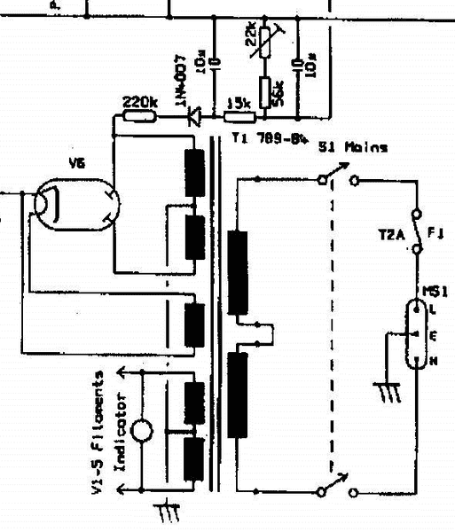

There is are two concerns I see.
1) The line power input fuse needs to be in the 'L' or hot side of the power line, before the On-Off switch. Real safety hazard where it is on the Neutral!
2) The fuse for the plate voltage (B+) is a similar situation, although perhaps not as severe. Consider moving it to V6 Cathode, but keep the V6 Heater connections direct to the tube socket.
I'm a bit curious about the grid bias on the output tubes. The resistor values are hard to read but it seems that the grid bias is 25% of the plate voltage.

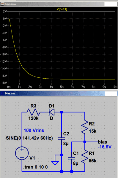

The circuit that generates the output stage grid bias is actually a half-wave rectifier generating a negative voltage. Notice the orientation of the rectifier diode. The 120k drops some voltage and limits current through the diode on negative cycles. In the photo that circuit is at the RH end of the component board.
There appears to have been a trim pot added to adjust that bias voltage. It fits with the addition of the two current measuring resistors.

Thanks Baluncore.
Sorry if I was unclear on that. My question was intended to ask how come the grid bias is so high. The resistor values in the bias circuit appear to be a divider with high side series 120k+15k=135k and low side 56k. This gives a ratio of 56/191 or -0.29 of the B+ voltage. If B+ is 250V then the grid bias is -72.5V, which seemed rather high.
The 120k has a low duty cycle, it is effective only while the diode is conducting.
A duty cycle of 25% changes it's effective value in the divider to 120k * 4 = 480k.
Because of the series 120k, the diode current follows the negative sinewave rather than holding the peak negative AC in the capacitor.

I could not resist simulating that bias circuit. Input 100 Vrms, 141.24 Vpk. Output settles to -16.9V.

Hi guys,
A little background may be in order. I received this amp from someone who had tried to build it. The solder connections were so bad I had to take everything apart and start over. It was a real mess. I removed a ton of solder and did my best to clean things up. The owner had damaged the power transformer which is on order now. There were components of the wrong value placed in the wrong place.
So...here I am with an amp with a set of build instructions. Paint by numbers as it were. The schematic did not match the build instructions in all cases. I had no idea if the designer knew what he was doing or not. The photos in the build instructions were not clear in some cases. I decided to put it together based on the build instructions first and then go back and fix what ever was wrong. I was aware of the line fuse issue and will change it.
This is a classic example of so call kits being sold to people who have zero skills and are in serious danger of killing themselves. The owner told me he had shocked himself two or three times messing with the amp. It is a wonder he did not harm himself or worse.
The photos and schematic you are looking at are from the instructions created by the designer/seller. These are the photos and instructions someone is supposed to used to put the amp together. Obvious failures!
It is not my intent to completely redesign this amp only to return it to the owner in a safe condition...hopefully working...lol. It was apparent to me from the start that there were probable issues with the grounding and one of the reasons I started this thread asking questions about grounding methods in general as this is nothing new having to deal with poor design.
There are obvious dangerous failures in the instructions and photos based on the fuse being on the neutral and not the hot wire from the mains for example. It is bad enough for someone like me to have to deal with dangerous design but it is unconscionable to sell this sort of stuff to the general public.
I did not start this thread for the specific purpose of repairing this amp but to use it as an example of issues I am often faced with. The issue of "noise" is one of the most frequent sometimes hard to track down problems I have to deal with.

Just a note about the B+ voltages. The high AC voltage secondary of the transformer center tap to one side is around 350 VAC. I expect to see a plate voltage of around 400 VDC on the KT66 plates and a little less than 300VDC on V2 pin six. The rest of the plate voltages should run between say 160VDC to 210VDC as a rough guess.
There was a made in China 5AR4 in the amp and I will replace it with a JJ GZ34 which I trust more to produce the correct voltage. The failed power transformer was a Magnetic Components 40-18033 which I am replacing with a 1202-55 made by Merren, who is someone I trust and slightly less costly than Mercury Magnetics who also make really good transformers but a bit pricey.

Combining the simulation results with the transformer voltage reading still had me wondering about the -59V grid bias. It turns out the KT66 tubes in ultra-linear configuration with 525V on the plates need -67V on the grids; followed by a footnote of: "A negative bias range of +-25% of this value should be available for each valve." So the -59V may be reasonable after all. Guess we'll have to wait and see if this is another design gotcha.

Notice that the bias resistor in series with the diode on the diagram is probably marked as 120k, but could be read as 180k.
The photo of the circuit board shows that a 220k resistor was actually used.
  • #42
There are better and later diagrams with fuse, switch and bias changes shown.
Given 375Vrms either side of the centre tap we get peak negative transformer voltage of 530V. Using this circuit with 220k and the pot adjustment, the bias it can be set from -36.9V to -49.5V. That assumes no G1 grid current flows.

I install in the actual amp the component values indicated in the schematic you posted with the exception of the primary side wiring. There is a pilot light, mains switch, and fuse which I had in mind to rewire like the schematic you posted.
I am not sure what the exact RMS voltage of the new transformer will be until it arrives. A quick measurement of the old one measured 367VRMS before it failed.
