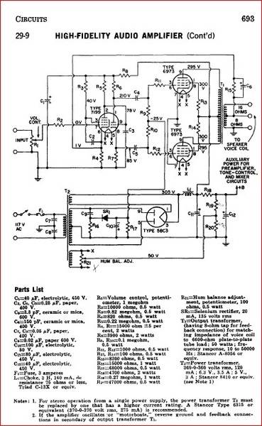

Take a look at 7199 it's designed for low hum audio
that 15 watt hifi amp in back of RCA tube manual RC30 works really well, i built one in high school
found that tube manual online as a pdf
old jm
Hi Jim,
I assume the grounding was connected to the chassis. How many separate ground points existed? I also assume a two wire AC mains with no low impedance path to Earth ground. Is this correct? I also have some questions about the hum balance circuit but we can leave that for later.
Billy

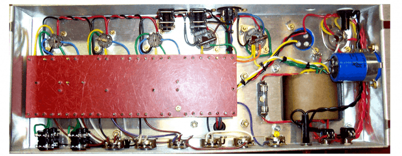

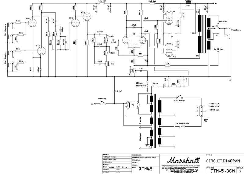

Guys...
I would also like to discuss this schematic. Should I keep it here or put it in a new thread?
Billy

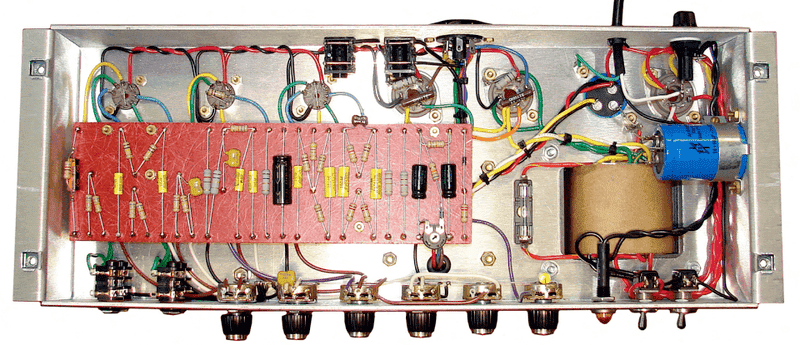

Photo of the chassis of the above schematic. There are a few minor differences from the schematic.
Billy
What about it?
Better photo of the above
Billy
Hi Baluncore,
Several things I have questions about.
First, there are two 1 ohm 2 watt resistors connected from the cathode of the two output tubes. The resistors are only there to provide a method of measuring current. They connect from the cathode pin directly to the chassis at the tube socket. Is this the best place to make this connection or should a wire be routed to one of the other ground points?

EDIT: this is the only connection to ground for the cathode so the resistors provide a path to ground but they could be just as well removed and a wire put in their place
NOTE: The questions are about best practice in general. There are no major faults in this amp and the signal to noise ratio is within acceptable limits.
Besides those two resistors, it looks to me like there are only two other connections to the chassis. They are on either side of the reservoir capacitor base in the picture. One is mains earth, the other is the –HT supply rail after the fuse. Note that there are no low level input signals connected to the chassis.
The two resistors need to be physically mounted at both ends so the local chassis was the easy way out. They should go back to the –HT but because they are not low level signals they can go through the chassis. It is a pragmatic solution. I would have soldered a wire parallel with the chassis to the –HT, to eliminate later bonding problems at the bolted contacts.
Thanks Baluncore,
The two resistors do nor appear in the original schematic and are not necessary to begin with. I think I will remove them as the plate current can be measured in other ways. I will then run two wires back to the "star" ground from the cathode pins. The photo is hard to see but there is also a ground wire running to one of the output tube resistor grounding points from the speaker output jack. I assume it would be better to also run it to the star ground.
Thanks,
Billy
You only need run one wire, the push-pull output tubes will take turns at using the same wire.
It is unlikely with tubes but you may develop a parasitic inductance problem with wire rather than sheet metal.
Speaker ground should be run to the exact same point as the low end of the output transformer secondary. Output circuitry must be ground referenced there as feedback is taken from the transformer secondary to the cathode circuit of the phase splitter.
good catch
you don't want that substantial speaker current flowing through any conductors that are carrying input signal currents back to their "ground" .
