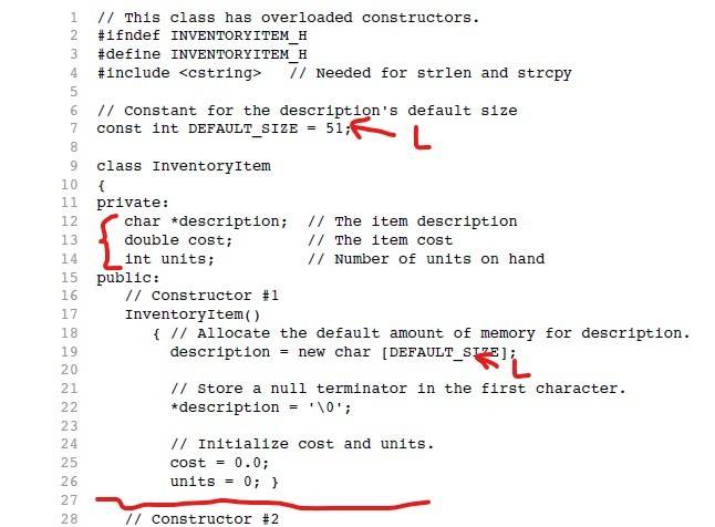

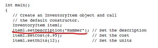

I follow the book, I am still learning about Constructor.
This is copy of the book on the same problem, I just put in the first part on InventoryItem.h( I am lazy, I called invItem.h), same as I use L instead of the long DEFAULT_SIZE:
This is the source.cpp in the book:
Notice the line I drew red line. It doesn't work. I have to use char cAr[]="Hammer". The book is not very good in this chapter.

If I were the one writing this program, I would use std::string throughout, including the 'description' data member. Nevertheless, I think yungman should write it both ways as an educational exercise: one version using C-strings, and a second version using std::string.

C++ allows a const to be in a header file without causing duplicate symbols but not a variable. Also, every InvItem can share the same DEFAULT_SIZE but not the same description. It's still not great to put the const outside the class in this case though because DEFAULT_SIZE isn't needed outside of the class.
https://stackoverflow.com/questions/12042549/define-constant-variables-in-c-header
I can't tell why the books code wouldn't work because you didn't show the implementation of setDescription. Nothing in the part you posted has any errors that I can see.
This is the code I got from the CD with the book and I want to show what doesn't work. It's in the source.cpp file
This is the source.cpp. I have to make correction to line 13, 21 and 26 to make it work using char cAr1,cAr2 and cAr3.

const int DEFAULT_SIZE = 51;
class InventoryItem
private:
   char *description;  // The item description
   double cost;        // The item cost
   int units;          // Number of units on hand
public:
   // Constructor #1
   InventoryItem()
      { // Allocate the default amount of memory for description.
        description = new char [DEFAULT_SIZE];

You made one mistakes copying the code from the book. On line 13, item1.getDescription("Hammer"); should be item1.setDescription("Hammer");
The book is probably a little outdated, because passing a string literal as a char * is now depreciated (it was legal, but now it's not). You have to use const char *, as the parameter type now for it to work.
Ha! The book is wrong, I did not type this from reading the book, I actually copied the code from the CD and ran. I did not even see they were get instead of set!
But still in line21 and line 26 is the same way. You cannot using set("Hammer"...), it has to be from a c-string.
That's something, the code from CD is wrong.
You have SHARP eyes!

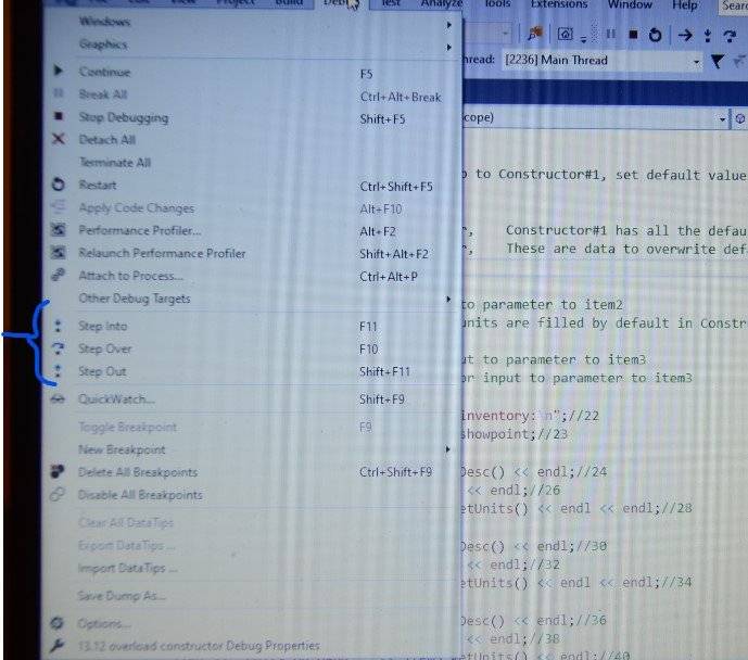

I just step through the program in post #81 one step at a time. I put breakpoint on each and every single line of code. I use F5 to step through one line at a time and LABEL what steps of the line from 0 to 44.
I want to see how the overload Constructor works. How does the main() step through the functions in the Class .h file. It really gives me an insight to how the whole program works. It is a lot clearer how the Constructors work particularly with over load.
I did not know that even though the pointer description is the same name for all 3 Constructors to allocate dynamic memory, EACH has it's separate address so I actually have 3 segments of memory each for one Constructor! This really answer a lot of my questions.
Just want to thank you guys for all the help. I really feel I am learning.
Alan
F5 is used to Continue executing the program. If you didn't have breakpoints, pressing F5 would cause all program lines to execute, either to the end or to some line asking for input.
What I do is to put one breakpoint somewhere near the beginning of the code in main(), hit F5, and then use F10 to single step a line of code at a time.
I use F10 (Step Over) and F11 (Step Into) a lot.
Step Into (F11) takes you into the body of a function so you can see exactly what constructors and other functions are doing.
Step Over (F10) just executes that line of code without taking you into the function body.

Here's a better way to use VS.
Put a breakpoint in main() at this line:
InventoryItem item1;
Press F5 - the line above will be ready to execute.
Press F11 to take you into the body of your default constructor.
Press F10 to skip over the function call, and take you to the next line in main().
It's not clear what you're saying here about three segments of memory. Memory segments are usually divided into stack, heap, and static memory. Each InventoryItem object that you create has its own chunk of memory on the heap, that will contain the item description. You have three overloaded constructors: a default constructor with no parameters, a constructor with just a description parameter, and a constructor with all three parameters.
Every InventoryItem object that you create will have three data members -- description, cost, and units. The difference is which constructor you use and whether the data members are filled in by a constructor or not.

Thanks for the suggestion on F11, I have to copy your response and print it out to read it slowly. I read F11, it said "step into" and show the dot. To me it's like step to the next break point. I did NOT know F11 is stepping one line at a time. So I did it the dumb way...dotted every single line! So I hit F5, I step through every line.
I am really having a ball with the debugger. Yes, 3 constructor creating 3 separate chunk of memories using the same overload pointer description.I want to ask you and the other experts. Do people use overload Constructors like in my example from the book in real world? It is interesting to learn...BUT in real life where programs are a lot bigger and much more complicate. Is it even a good practice to use overload Constructors where you pretty much have to be forced to use overload variables like description, units, cost in the program in post #67? That all have the same name and you have to keep tract of them at all times.
F11 will step into the function one step. F10 will step over the function call and go to the line right after the call to the function. If you know that a function is working correctly it makes more sense to step over (F10) the function call, but if you're debugging the function you want to step into it (F11).
