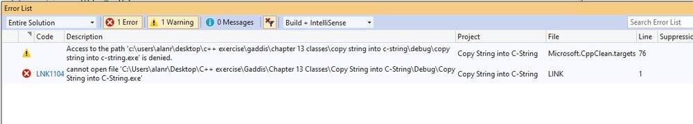

I know, It compile and everything works the first time. But I cannot even build solution without having error. I don't know why.
I have so much trouble with VS I just assume I did something wrong.
Thanks

The warning and error you show in post #3 is likely due to a permissions issue. After you built your program, when you click Rebuild Solution, what happens is that VS deletes all of the intermediate files and .obj files and the .exe file (but not your .cpp and .h files), and then recompiles your code and links in any library code your program uses. I believe the warning and error occurred because VS does not have permission to delete the old executable. You can probably get around this by starting VS as an administrator. Then it shouldn't have any problem rebuilding.

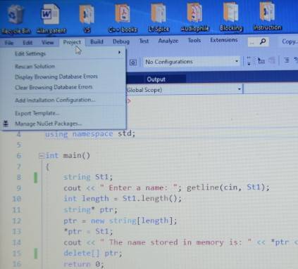

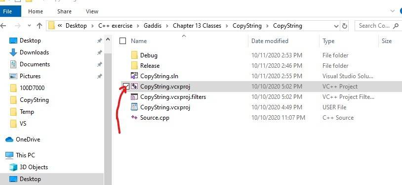

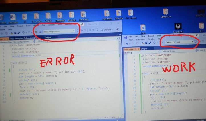

I have been looking at the difference between the two projects comparing all the taps, these are the difference I found:
This is one difference between the one with compile error(left) vs one that works.
The Project option menu is different. This is the one that works.
This is the one that gives error:
These are the difference I can see between the two. I am sure I did not change any setting on the one that was working before and not working later.
Thanks
"comparing all the taps" -- ? Do you mean "tops"?

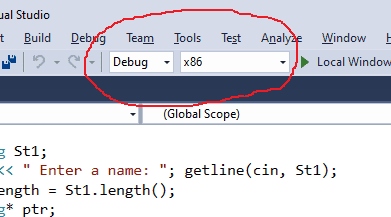

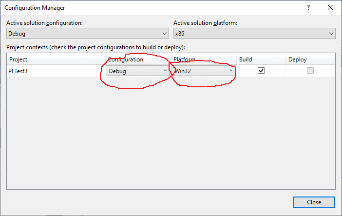

The program that doesn't work isn't configured correctly. The one that works is configured to build in debug mode for the x86 architecture (i.e., 32-bit Windows). The one that doesn't work doesn't seem to be configured at all. I don't know how that would have happened.
I'm running an older version VS, but I'm pretty sure this will work in yours - on the Build menu, click Configuration Manager... In the Configuration Manager dialog, choose Debug for the configuration and Win32 for the platform. Then click Close.
The other configuration option is Release, and the other platform option is Win64. The debug option inserts extra instructions so that you can run your code in the debugger. The Win64 platform option produces 64-bit code. For what you're doing I would use Debug and Win32.

Thank you so much.
The RELEASE WORKS. Even when I change to DEBUG x86, it doesn't work. Why did it change on my on the first place? I sure did not play around with that when it went from working to error yesterday. And I notice last night when I doing the comparison and pulling down the option, I did not see the option to get the Debug and x86. So I gave up. But this morning after reading your post, I open the problem project, it had Debug and x86 on it! It seems to keep changing.
What are the Build Configurations for? How do I avoid changing them. I sure NEVER open this window and change it ever.In the image below, those are called TOPS? I did not know that. What do you call the two that said Release and x86? These are names that I consistently run into problems. That's what make it so hard to read stuffs. If you tell me to expand or collapse the folder before yesterday, I won't know what you mean.
Thanks
It should also work in Debug x86. When you said earlier about not being able to build your program, I said that I thought it might be because of a permissions issue, which is unrelated to debug/release x86/x64.
In a different post (#10) you showed in image where it said "No configuration". My response to that was to set the configuration.

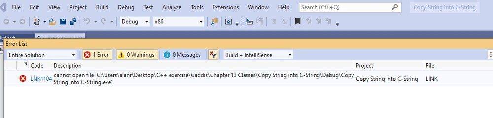

See, I can just change back to debug and it failed. This is the error message, it's the same as before, that's why I did not copy the message.
Thanks
But you didn't say it was the same error as before, and that's why I asked.
The error is a linker error, LNK1104. If I do a search using LNK1104 as the search string, the first article that comes up is this one: https://docs.microsoft.com/en-us/cp...rrors/linker-tools-error-lnk1104?view=vs-2019
The first paragraph of the article is this:
This error is reported when the linker fails to open a file, either for reading or for writing. The two most common causes of the issue are:
  • your program is already running or is loaded in the debugger, and
  • your library paths are incorrect, or aren't wrapped in double-quotes.
There are many other possible causes for this error. To narrow them down, first check what kind of file filename is. Then, use the following sections to help identify and fix the specific issue.
If the program is already running or loaded in the debugger, you'll get this error.
The path that is shown in your error message has many spaces in it. You should stop including spaces in the names for your directories.
Sorry, I kept seeing the same error report, I just took for granted everyone saw that.
You mean the name of my project " Copy String into C-String" has too many spaces? I notice when the name is too long, VS doesn't like it and reject out right when I create a new project. I try to be descriptive in the name so in the future when I look at the name, I know what I am looking for.
thanks
Yes, way too many. If I were doing this I would name the project CopyString -- no spaces. Instead of putting the description in the project name (and the resulting filename for your project, you could create a text file or Word file with a list of the the project names and as long a description as you would like for each one.
I have several hundred projects I've done - no spaces in any of the project names.

I actually when and change the name every single file in the project from "Copy String to C-String" to just CopyString. When I open the new project( new name, same project), it complained, but when I click this in the File Explorer:
It run and works. I went to Project-->Configuration Manager, it showed Debug and x86. Yes, shorten the name make it work!
THANK YOU SO MUCH. I am really learning.

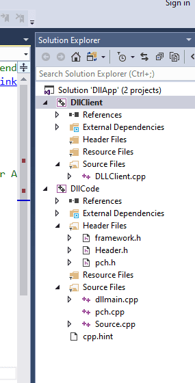

I have a very simple question, I never understand what is Solution and Project. Sounds like Solution is the superset, a Solution can contain more than one project and you can choose to compile any specific project or all at one time. Am I correct?
Yes. Here's a screen shot of one of my programs.
The solution, DllApp, consists of two projects, DllClient and DllCode. The build rules are different for the two projects, as DllCode is compiled and linked to produce a DLL, while DllClient is compiled and linked to produce an executable (.exe) that uses two of the functions that are exported from the DLL.
