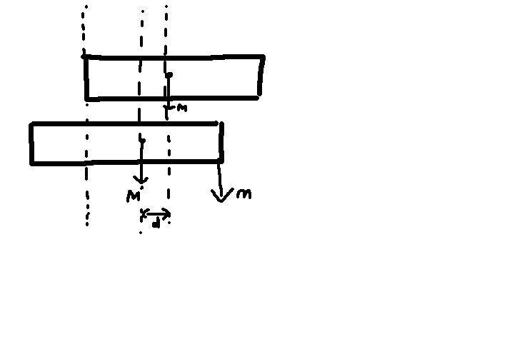

The question is posted here: http://galileo.phys.virginia.edu/classes/252/mass_and_energy.html
I'm not too convinced by their explanation of 'compensation of shift in centre of mass'
What I understand is this:
1)Box of mass M moves distance d leftwards
2)To prevent centre of mass moving to the left, a small mass m is 'added' to the right endThen shouldn't it be:
M(d) = (L/2 - d)m
The difference between my answer and theirs is that:
I take the reference point to be an absolute, fixed point in space - the centre of the Box initially.
However, their reference point is the left-end of the box. But that has clearly moved a distance 'd' leftwards.
This raises the important question:
Do we 1)select a reference point that is fixed in space, unchanging with time OR 2) select a reference point in the same frame of reference (left end of the box in this case)
A simple thought experiment:
Imagine a box of length L, with its centre of mass initially at (0,0). Some time later the box moved 10 units right, with its centre of mass now at (10,0). Taking either (0,0) or left end of the box to be the reference point in this case would yield the same result..
However this doesn't seem to be the case in this experiment..
