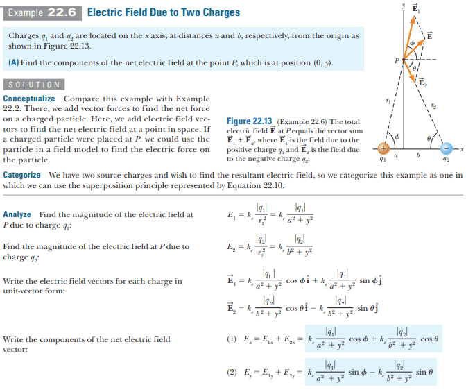

The problem and solution is,
Textbook worked example 22.6 on electric field due to two charges: diagram with charges q1 and q2 on the x axis at distances a and b from the origin, point P at (0, y), with field vectors E1, E2 and resultant E, followed by solution equations for the field magnitudes and vector components.

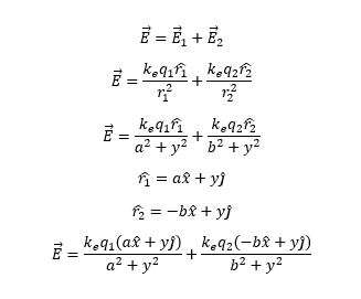

However, I would like to know why it cannot be solved like this:
Stacked equations deriving the electric field from two point charges: E = E1 + E2, then E = (k_e q1 r1-hat)/r1^2 + (k_e q2 r2-hat)/r2^2, then with r1-hat = (a x-hat + y y-hat)/(a^2 + y^2) and r2-hat = (-b x-hat + y y-hat)/(b^2 + y^2) substituted, ending in the combined expression with denominators a^2 + y^2 and b^2 + y^2.
Thanks for any help!
TSny said:
Are these unit vectors?
Thanks for your reply @TSny! Yes the two r hat vectors are unit vectors. I guess then they should both have a magnitude of 1. How would you write the x hat and y hat unit vectors in terms of the r hat vectors?
Your expression is dimensionally incorrect. The spatial dependence goes as the inverse length not as the inverse length squared. As @TSny noted, you need unit vectors.
If you have a point charge ##q## at position ##\mathbf{r'}##, the electric field vector at a point located at ##\mathbf{r}## is given by $$\mathbf{E}=\frac{k_e~ q(\mathbf{r}-\mathbf{r'})}{|\mathbf{r}-\mathbf{r'}|^3}.$$ To see how it works in this case, consider the negative charge ##q_2##.
Its position is ##~~\mathbf{r'}_2=b~\hat i##
The point of interest is at ##~~\mathbf{r}=y~\hat j##
Then
##\mathbf{r}-\mathbf{r'}_2=-b~\hat i+y~\hat j~;~~## ##|\mathbf{r}-\mathbf{r'}_2|=(b^2+y^2)^{1/2}##
With this mind, the electric field due to ##q_2## is $$\mathbf{E_2}=\frac{k_e ~q_2(-b~\hat i+y~\hat j)}{ \left(b^2+y^2\right)^{3/2}}.$$ Note that this expression is a magnitude $$E_2=\frac{k_e ~q_2}{ b^2+y^2}$$ multiplied by a unit vector $$\mathbf{\hat e}_2=\frac{(-b~\hat i+y~\hat j)}{ \left(b^2+y^2\right)^{1/2}}.$$Your expression was almost there.

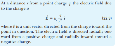

I have only learnt about:
Textbook equation (22.9): electric field E vector = k_e (q / r^2) r-hat at distance r from charge q, with text explaining r-hat points from the charge toward the point and field is radially outward for positive charge, inward for negative.
I see by inspection that r hat vector is equal to r^ = r - r'. However, why is the absolute value of r - r' cubed?

Equation: r-hat 1 = a x-hat + y j-hat, where r-hat 1 is written with a hat symbol and the right-hand side is a x-hat plus y j-hat.
The magnitude of the right-hand side is ## |a \hat x + y \hat j| = \sqrt{a^2+y^2}##. This is not equal to 1, so ##a \hat x + y \hat j## is not a unit vector.
But we can get a unit vector representing ##\hat r_1## by dividing ##a \hat x + y \hat j## by ##\sqrt{a^2+y^2}##. Thus, $$\hat r_1 = \frac{a \hat x + y \hat j}{\sqrt{a^2+y^2}}$$ Now, consider the x-component of ##\hat r_1##: $$\frac{a }{\sqrt{a^2+y^2}}$$ How is this related to the angle ##\phi##?
Textbook equation (22.9): electric field E = k_e (q / r^2) r-hat at distance r from a point charge q, where r-hat is a unit vector from the charge toward the point.
Perhaps now is the time to learn it. The one you know, equation (22.9), is not general enough because it assumes that the point charge is located at the origin. How would you express the electric field vector if the origin has already been chosen for you and the charge is not at it?

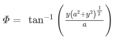

Thanks for your replies @TSny, I think
Equation: Phi = arctan(y/a), written as Φ = tan⁻¹(y/a).
. But since you said that the x-component of the
was
Fraction with numerator a and denominator the square root of a squared plus y squared, a typical factor in an electric field x-component calculation.
then a =
so
Equation: Φ = tan^-1( y(a^2 + y^2)^(1/2) / a ), an inverse tangent expression in y and a.
But to be honest, it dose seem a bit strange that a =
, did I do something wrong?
Many thanks!

You are complicating things unnecessarily. Look at the ratio ##\dfrac{a }{\sqrt{a^2+y^2}}##. Now look at the drawing. The denominator is the hypotenuse of the right triangle on the left with ##q _1## at its corner. Right side ##a## is adjacent to given angle ##\phi##. So the ratio is $$\rm{Ratio}=\frac{\rm{Adjacent}}{\rm{Hypotenuse}}.$$ Does this ring a bell?

Callumnc1 said:
I think ##\phi = \tan^{-1} \frac y a##.
Yes, this is correct. Can you express ##\frac a {\sqrt{a^2 + y^2}}## as some trig function of ##\phi##?
Callumnc1 said:
But to be honest, it dose seem a bit strange that ## a = \frac a {\sqrt{a^2+y^2}}## , did I do something wrong?
Right, this equation is not correct. I don’t see how you arrived at it. Remember, your original equation ##\hat r_1 =a \hat i+ y \hat j## for the unit vector ##\hat r_1## is not correct. So the x-component of ##\hat r_1## is not equal to ##a##.
