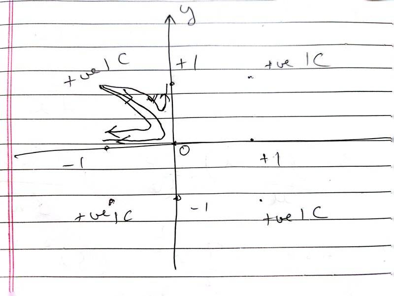

However, if the scenario was four equal point charges at the four corners of a square, then I have no clue about why line of force cannot be discontinuous. I know that electric field at the center of the square is zero, but the electric lines of force will not suddenly become discontinuous at the center of the square.

A field line is drawn by starting at some arbitrary point and following the field vectors. See https://en.wikipedia.org/wiki/Field_line. If your four charges are at ##(\pm 1,\pm 1)##, start at ##(-.9, -.9)##. The line will take you to the origin, meeting similar lines from the other three charges. But they don't stop there. Can you figure out where they go?
For an analogy, imagine walking down a hillside towards a saddle point. If you want to keep going downhill, not up the hill in front of you, where do you go?

I think the field lines emanating from the four positive point charges would be directed towards the center, but since field lines cannot intersect so the lines coming from each charge will turn away from the center and away from the field lines due to the adjacent two charges.
But even if I figure out correctly the path of the field lines as they go towards the center of the square assuming that a line of force does not break in in its path, we still cannot explain why these lines of force cannot have breaks/gaps in it's path.

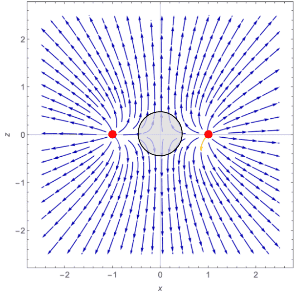

It would be unphysical because it would violate Gauss's law. If you construct a Gaussian surface that encloses the point where the field line disappears without a negative charge to end it, then you have non-zero net flux through the surface while the enclosed charge is zero.
As @Steve4Physics already said and you seem to agree, filed lines are constructs to help us visualize forces on test charges. One can create a set of field lines by moving a test charge charge around in space and drawing small arrows at each point representing the force on the charge at that point. Such a
picture is shown below for two equal positive charges placed on the x-axis. The electric field at the origin is zero and no arrow can be drawn at that point. A zero vector has no direction and no magnitude.
However, you can draw a Gaussian spherical surface (gray circle) and note that that electric flux through the surface is zero which means that you get an equal number of field lines going in as coming out. This is at is should be because there is no enclosed charge. You can shrink the radius of the Gaussian sphere to an arbitrarily small (but non-zero) value and you will still have as many lines going in as coming out. Thus, I think that it is fair to say that the field lines are continuous within the Gaussian surface.
