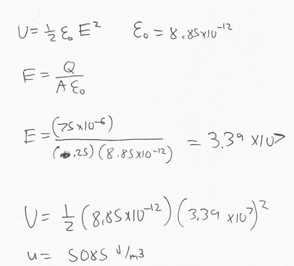

Two large non-conducting plates of surface area A=.025m^2 carry equal but opposite charges Q = 75microC. What is the energy density of the electric field between the two plates.
I wrote the equations on my attempt. This was a multiple choice problem and the correct answer he gave us was 1.7*10^7 but he's been wrong before.
Any help is appreciated!
Try again. A=.025 The rest looks correct.

The new answer I get is 508475 instead of 5085. I feel like I may be using a wrong equation or something? My teacher didn't really lecture on energy density at all so I'm a bit uncertain.
I think you got the rest correct. I think your teacher's answer of 1.7E+7 may be incorrect.

My answer isn't even one of the multiple choices?
What is the distance between plates?
Energy density is
ω = W / V = E / (Ad)
where W - energy, V - volume, d - distance between the plates.
Capacity of the system (actually, we consider a capacitor)
C = ε0A/d
Energy
W = Q2/2С
Hope, it is enough to find the solution.

The problem doesn't say the distance between the plates.
But have it in your mind.
Derive the final formula.
@justin15501 Please let us know if your teacher agrees with your answer. I do think you computed it correctly.
My answer is
5.085⋅105 J/m3?
Regards to your teacher )
