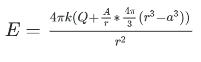

There is given a spherical shell with an inner radius of a and an outer radius of b, and there is a point charge +Q in the center. The volume charge density of the charge in the shell is A/r where A is some constant.
Find A if the electric field inside the shell is constant.

I am restudying electrostatics right now, and I am facing difficulties in the following question:
My attempt:
I tried to use Gauss' law, what I got is the equation in the capture but that doesn't lead me anywhere as I am unable to find a value that will result in a constant field inside the shell. What am I doing wrong?
Of course that the equation is for a<r<b
Eitan Levy said:
what I got
And how, precisely, did you get that ? (you want to know what you did wrong, so we want to know what you did. But all you telll us is the outcome -- which is wrong - or not)
My clues:
  1. for QQ alone the field is ##kQ\over r^2##kQr2 and not 4π4π times as much
  2. you multiply ##A\over r## with a volume -- that's not Gauss !
Simply by looking at a sphere with a radius of r. The total charge inside the surface of this sphere should amount to Q, the point charge plus the charge in the shell until we reach a distance of r. Then I simply used the formula for Gauss' law.
How do you calculate that ?

Actually I am still unable to reach a solution.
I calculated that by calculating the integral of A/r*4πr^2dr from a to r, I got 2πA(r^2-a^2) as an answer.
EDIT: Never mind I got it, thanks.

You may be misinterpreting the question.
A spherically symmetric charge generates no field inside itself. They must mean the field is constant between the inner and outer radii of the shell.
This does not require integration. Consider a point at radius r between a and b. What is the field there due to:
- the point charge
- the spherical charge between a and r
- the spherical charge between r and b?
requires integration ...
:smile: Yes, that's true. (integration is required to find the charge inside the shell; or even the charge inside the shell from radius [itex]a[/itex] to [itex]r[/itex]).
But I must be misinterpreting the problem. I can't seem to find a solution where both [itex]E[/itex] and [itex]A[/itex] are constants (for any [itex]r[/itex] that lies inside the spherical shell). I attribute that to my misunderstanding of something, somewhere or another. 🤔
It can be avoided. Consider the rate of change of the field as radius increases at radius a.
For the field due to the point charge that rate is ##-\frac{2Q}{a^3}##. For the spherical shell it is ##4\pi\frac Aaa^2\frac 1{a^2}=\frac{4\pi A}a##.
The sum of the two must be zero.
Arguably, this approach assumes there is an answer.
Nevermind. I see my misunderstanding now. :smile: For a specific value of A (depending on other paramters such as Q and a), both A and E can be made to be constants for the region between a and b.
