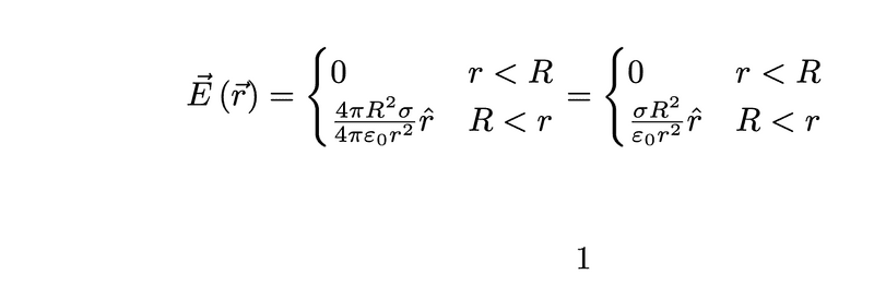

I am having a bit of a problem understanding what to visualise since in the first part we found the electric field resultant from the disc shell The goal is to calculate the electric field at a point on the z-axis, at a distance z from the center of the disk.

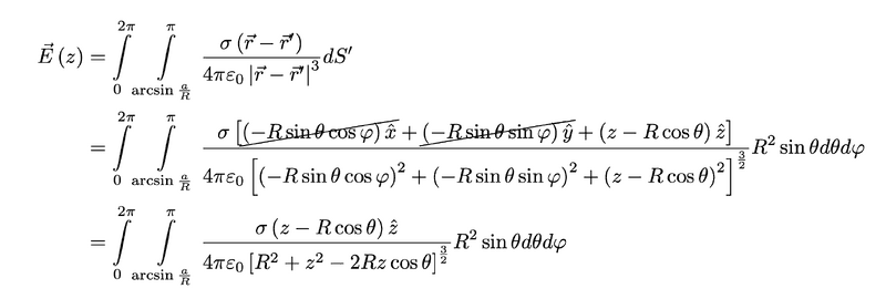

now after they cut of the circle
but I am failing to understand the question ,is not the shell hallow if they are removing a disc where are they removing it from
I tried to read the solution yet I don't understand the question ,if a visualisation can be provided I am thankful

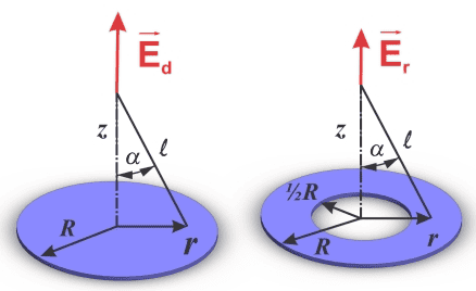

The "relevant" equation that you show is not relevant here. There is no shell. See here for the relevant equation. You want the electric field on the axis of symmetry at some distance from the center of the disk.
The disk with the hole at its center has the same field on the axis as a whole disk with charge density ##\sigma## plus the field from a second concentric disk of same size of the hole that has negative charge density ##-\sigma.##

I'm unclear how this problem involves a "shell". To my understanding, the configuration described looks like this:
except that in the problem, the hole in the second disk is much smaller in diameter than in this illustration.
(Illustration is from here.)

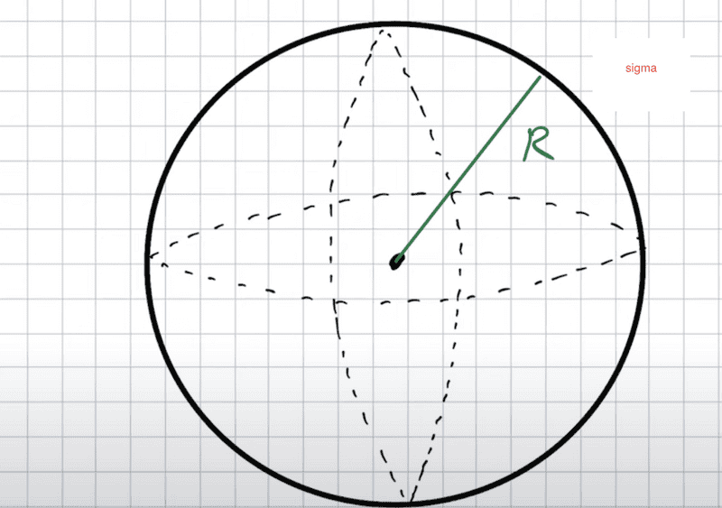

first and for most thanks to everyone for the quick replies , I think as everyone stated imagining something like this would do the trick and solving using superposition instead of integration would be wiser ,
the thing is though I am learning the course in a language thats not my native one , but the term they used in part one of the question was a thin spherical shell
and the solution for part 1 did indeed align with the term
then they demanded to use the result of section A
and used the spherical shell term so I could not imagine what the problem intitles
they even used a bit of a different approach for the same section and wrote in English electric field of a sphere and a disk and used them
I think I am starting to understand what they meant thanks to all of you
it seems like they did indeed consider a spherical shell but with a small hollow disk removed
and gave me a radius a<<R so I can use an approximation to solve the integral or use superposition
and assumed with such approximation the disk field should be similar to an infinite charged plane field
