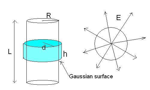

The Gaussian surface is not the same as the surface of the total cylinder (or disk or plate). One usual problem says that the charge is distributed evenly on the surface of an empty cylinder of length L and radius R<<L, and the surface charge density σ is given; what is the electric field at a point opposite to the middle of the cylinder at distance d<<L from its axis.
You take a Gaussian surface in form of a short concentric cylinder (high h<<L) at the middle of the cylinder (far from the ends) The electric field is radial there by symmetry, so there are no field lines crossing the top and bottom plates of the Gaussian cylinder. The net flux through the Gaussian is (2πdh)E, the enclosed charge is q=2πRhσ, so E(d)= (σ/ε0)(R/d).
The problem can also say that it is an insulating cylinder of net charge Q, distributed evenly in the volume. In this case, the enclosed charge in the Gaussian is Q V(Gaussian)/V(cylinder).
Ah, I see, because the Gaussian surface is inside the actual surface, even the top and bottom plates would have E-fields emerging radially from the axis. Hence, the Gaussian surface would only have E-field emerging from lateral sides. Thank you very much ehild. :)
