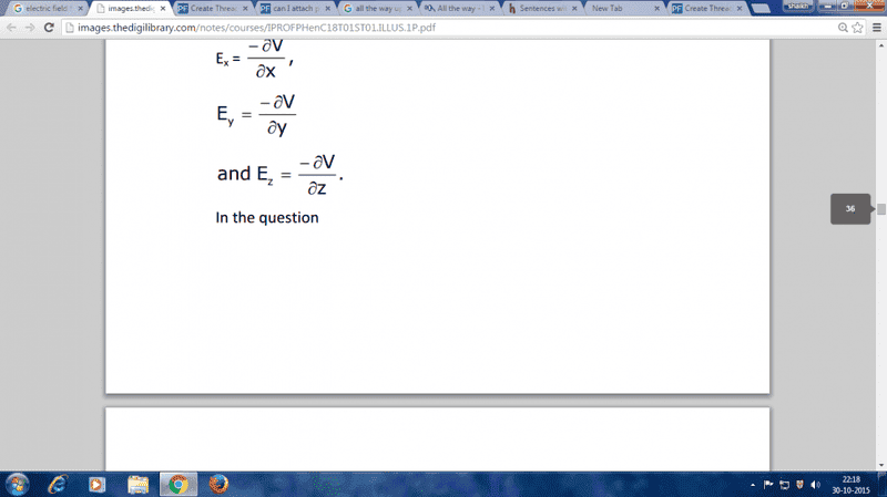

The electric potential existing in space is V(x,y,z)=B(xy+yz+zx).Find the expression for the electric field at point P(1,1,1) and it's magnitude if B=10 S.I unit.
https://www.physicsforums.com/attachments/91091
3. The solution
I actually do have the solution of problem,but I have many doubts regarding the solution.
So want to list them and have them resolved.The solution is
http://images.thedigilibrary.com/notes/courses/IPROFPHenC18T01ST01.ILLUS.1P.pdf
page no 36 to 38.
For those who(their computers :wink:)could not open this pdf and so you don't have to scroll down all the way up to page 36
Query: I will mention one ,by the time it gets resolved I will mention second ...
V=B(xy+yz+zx) why?According to the question V(x,y,z)=B(xy+yz+zx)
Where did (x,y,z) go?
[ ATTACH=full]91091[/ATTACH]
3. The solution
page no 36 to 38.
[ ATTACH=full]91095[/ATTACH]
[ ATTACH=full]91096[/ATTACH]
[ ATTACH=full]91097[/ATTACH]
[ ATTACH=full]91098[/ATTACH]
[ ATTACH=full]91099[/ATTACH]
V(x,y,z) = B⋅(xy+yz+zx) is simply saying that the electric potential, V, is a function of x, y, and z. and at some point, (x,y,z), V is given by the formula indicated.
They merely left off the x, y, and z .

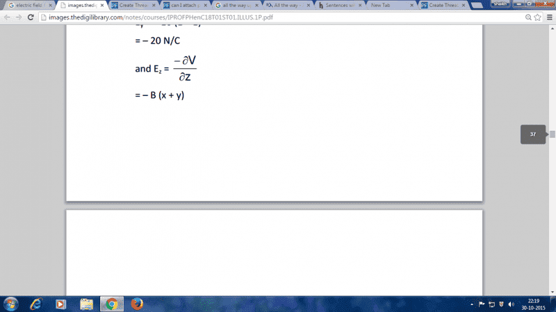

V=B(xy + yz + zx)
So,
##Ex##=##-dV##/##dx##
=– B(y + z)
I did not understand this part.
The problem appears to be saying that the variables V,x,y,z can be assigned values that are consistent with V=B(xy+yz+zx), where B is just another real number, not a function. So we have
$$\frac{\partial}{\partial x} V=\frac{\partial}{\partial x} B(xy+yz+zx)=B\frac{\partial}{\partial x}(xy+yz+zx).$$

gracy said:
How you came to know that B is just a real number?
It's clear from the context, as Fredrik pointed out. The problem is poorly worded:
A better way to state it:
The electric potential existing in space is V(x,y,z)=B(xy+yz+zx) where B is a constant whose value is 10 in SI units. Find the expression for the electric field at point P(1,1,1) and it's magnitude.
Or better yet ...
The electric potential V=B(xy+yz+zx) where B is a constant whose value is 10 in SI units. Find the expression for the electric field at the point (x,y,z)=(1,1,1) and it's magnitude.
Since this is a worked example, the meaning can be determined from the context of the solution.

And what about post#15?
You have a sign error. See Post #17. Otherwise either of your expressions is valid.
The notations ##\frac{\partial V}{\partial x}## and ##\frac{\partial V(x,y,z)}{\partial x}## are both acceptable. I would say that the V in the former former expression is the variable that occurs in the equation V=B(xy+yz+zx), and that the V in the latter expression is the function defined implicitly by that equation.
Regardless of notation, only functions have derivatives (variables do not), so the former expression can't be interpreted as a partial derivative of the variable. It must be interpreted as a partial derivative of the function.
You need a minus sign, since the relationship between E and V is ##\mathbf E=-\nabla V##.
(I wrote this before I saw that Mister T had already replied).

gracy said:
So,we can write like this
##Ex##=##-dV(x,y,z)##/dx
No, that would be confusing and, technically, wrong. If the value of ##V## depends on the values of ##x##, ##y##, and ##z## then taking the derivative with respect to ##x## will not give you ##\text{-} E_x##. You have to take the partial derivative with respect to ##x## to get the x-component of ##\vec{E}##.
$$E_x=-\displaystyle \frac{\partial V}{\partial x}$$
People write ##V(x,y,z)## simply to emphasize that the value of ##V## depends on the values of ##x##, ##y##, and ##z##. More in the way of a warning, or hint, about the right way to think about ##V##. So if I tip you off with my notation that ##V## depends on all three independent variables, and then tell you to take the full derivative to get ##E_x##, I'm steering you towards an error.
On the other hand, if ##V## depends only on ##x## then you might see
$$E_x=-\displaystyle \frac{dV}{dx}.$$
You ask some good questions, Gracy. They remind us that as teachers what we ask our students to do isn't stuff that just follows from our explanations, however lucid they might be. It takes practice applying it before the meaning has any chance of being clear. So, thank you for that.
