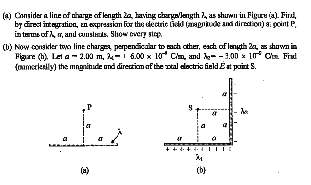

http://imgur.com/W4Ntkfb
E=KQ/R2
e= electric field
Q = charge
R = radius from point to charge
K is a constant, 9x109
http://imgur.com/4CTEwDw
If my handwriting sucks, I basically did the standard integral of k[itex]\int[/itex]dq /r2 but kept the r hat vector since there is symmetry and I know that the magnitude will be be in the y direction. I used dq=[itex]\lambda[/itex]dx and r2=x2+a2 which gave me an integral that was an arctan integral. By substituting a for x, I got [tex]E= \frac{k \lambda \pi}{2a}[/tex] in the radial direction.
The answer should be √2k[itex]\lambda[/itex]/a upwards and perpendicular to the line of charge

##\hat{r}\ ## depends on x, it's not constant.
You failed to take that into account.

Oh right it's not constant in direction... was just thinking of that as a constant. Derp, shouldn't be studying this late. Thank you. Redid it with Ey and got it.
