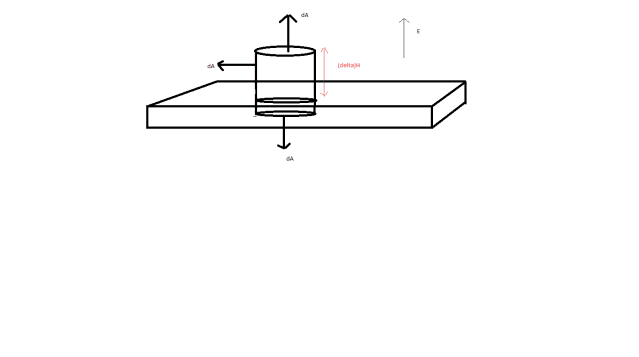

A metallic surface is placed in an electrostatic field. Derive an expression for the electric field on the metal surface.
\oint \underline{E} \cdot d\underline{A}=\dfrac{q_{enc}}{\epsilon_0}
My initial thought was to set up a cylindrical Gaussian surface, I've tried to show it in the picture attachment.
Then the dA facing downwards will be 0 since the electric field within the metal is 0, and the 'side' of the cylinder dA is perpendicular to the electric field and also 0. So the only contribution is the upward facing circular area. Letting Δh→0, it gives the electric field on the surface, EA=q/ε, and q/A=σ the surface charge density. So E=σ/ε.
Is this method correct, I'm not entirely sure to be honest.

The total field is the sum of the external applied field plus the field due to the charge on the surface of the metal. Inside the metal the fields are in opposite direction and cancel. Outside they are in the same direction and add up.

That solution is not correct. The side area does not contribute because the field is parallel to the surface.
Imagine a parallel plate capacitor with potential V across the plates, and you slide a plate inbetween the plates. What is the E field before & after sliding the plate?
(You can use 5 Gaussian surfaces to derive 6 equations in 6 unknowns; the last equation has to do with the voltage V).
