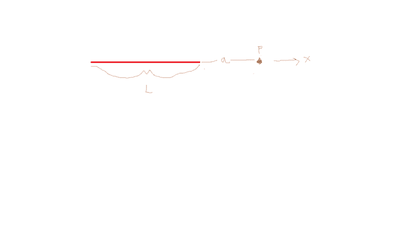

there's a rod and has ##a## length ##L## and we want to calculaate the electric field far from rod like ##L<<a##
I found the equation for a normal case and it was ##\frac{1}{4\pi e_0}\frac{2Q}{L^2}\left(ln\left(\frac{a}{L+a}\right)+\frac{L}{a}\right)## .Itn non-uniform that's why there's ##2## anyway in the ##L<<a## case it will be just ##\frac{1}{4\pi e_0}\frac{2Q}{L^2}## .
You might ask you did so far how you can't do that well I am not sure about the ##\frac {L} {a}## term it seem like it will be ##\frac {1} {a}## but in that case the units will not match so it must be 0.When something like this happens we will think ##a→∞## ?

I don't know why you think it would be like 1/a. As you say, it will tend to zero as a tends to infinity, but the same is true of the log term, leaving you with zero overall. Of course, that is trivially true, but we need the first nonzero term in the approximation.
So you need to start by expanding the ln as a power series.

Presumably the rod is charged in some way? Uniformly?
How is the point at distance ##a## positioned with respect to the rod? For clarity, suppose that the rod is lying along the y-axis with its center at the origin. Is the point ##a## located somewhere along the x-axis, or perhaps the y-axis?

I wrote the question so silly way sorry for that.Charge distrubiton is not uniform and its like λ(x)=bx (https://www.physicsforums.com/threads/electric-field-dimension-analysis.906014/ this thread also the first 2 parts of my question)
Here a picture to make things clear
I choose the left end of the rod is origin.
its positivly charged

That's the right approach, but you need to keep another term from the expansion. This a general rule in problems like this... keep just enough terms that the result is not zero.

Why are leaving another term ? Dont we want it to be a zero ?
So we will write ##-e+\frac {e^2} {2}+e## and ##\frac {e^2} {2}=0## again ? (e means epsilon)
##\frac {ε^2} {2}## will not be zero its ##\frac {L^2} {2a^2}## so my E will be
##\frac {1} {4πε_0} \frac {Q} {a^2}## which that's what we want.

Arman777 said:
so the other terms would be zero ?
No, the other terms would be considered to be negligible.
