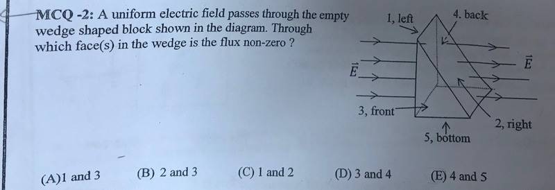

Electric flux through a wedge shaped block

Multiple-choice physics diagram of a wedge-shaped block with a uniform electric field E passing through it, faces labelled 1, left; 2, right; 3, front; 4, back; 5, bottom; answer options (A) 1 and 3 through (E) 4 and 5.
Flux on opposite sides = 0
The answer is (E) , right ?
  • Multiple-choice physics diagram of a wedge-shaped block with a uniform electric field E passing through it, faces labelled 1, left; 2, right; 3, front; 4, back; 5, bottom; answer options (A) 1 and 3 through (E) 4 and 5.
Why?
Nope.
## \Phi_e = \Sigma~Q_{Enclosed} = ##
kuruman said:
Nope
It's (D) , because the angle is 90 ( the surface is perpendicular to the field )
The answer is not (D). You are correct in saying that the flux through 4 and 5 is zero. However, the problem is asking "Through which face(s) in the wedge the flux is non-zero?".
C
