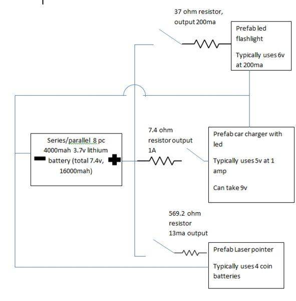

I haven't tested if they can handle the voltages yet since I am currently at school, but I made a quick design, it is the fourth circuit diagram I have made before so it isn't perfect.
Alright here it is

Not bad. You realize that the resistors will eat up a big fraction of the battery energy?
The flashlight and the pointer may possibly work with just 3.7v. It is worth testing before building a circuit.
A prefab car charger? Like this?
It puts out 5v, but it takes in 12-24v the car's voltage. So, to use that you need to increase the voltage, not decrease it with a resistor.

I know the resistor would use up charge but i thought it was needed to get the right current. I will test the laser pointer and flashlight once I get home. I will try getting a 3.7b usb charger like you mentioned
Try them at 3.7v not 7.4v.

I tested them with 3v since I happened to have some aa batteries and the flashlight works fine, as for the laser pointer I could not find it but I do have a laser diode mixed in with my spare electronics scrap, that I think is from a dvd player. So I will test that tonight
Good start. But it is possible the pointer will work at 3.7v but not at 3v.
I just found and tested the laser pointer and it works at 3v. I also used an ohms law calculator so I could quickly double check the current of the flashlight and since it says it is a 5mw and normally works at 4.5v it uses 1.111ma with 4050ohms of resistance. The resistance sounded too high to me so can you double check that
Electronic things are not linear. That means that Ohm's Law is not useful predicting their behavior.
The current values you showed in your circuit diagram are maximum values. That means they might draw any current less than the max.
So I suggest you forget about currents. The device either works or doesn't work at the voltage you provide.
The exception may be the cell phone. Many of them are "smart" That means if they have a weak charging source, they slow down the charge rate, so it would take a lot more time to charge.
So, you said the flashlight works, the pointer works, and there is a 3.7v USB charger. I think you're all set without any special circuit or resistors. The simplest is to use one AA size battery for each device. Don't bother to connect them to each other. When you buy the lithium batteries, you can also buy a recharger for them.
