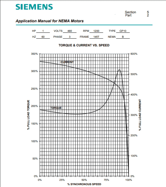

If a motor slowed to a halt, will the current go up or down
When an electric motor slows to a halt, the current increases significantly due to the absence of reverse Faraday EMF, which normally reduces current during operation. In AC motors, this phenomenon is referred to as "Locked Rotor Amps," while in DC motors, it is known as "Stall Current," which can be ten to twenty times the running current. The discussion highlights the risks associated with stalled motors, such as potential damage to windings and insulation. Universal motors, commonly used in vacuum cleaners, are noted for their high starting torque and lightweight design, making them suitable for high RPM applications.
PREREQUISITESThis discussion is beneficial for electrical engineers, motor control specialists, and hobbyists working with electric motors, particularly those interested in the implications of motor stalling and safety precautions in DIY projects.
Charles Link said:This looks a little like a homework question, but I'll assume it isn't.## \\ ## I believe when an electric motor is rotating, it causes a reverse Faraday EMF in the primary current input line, thereby making for a lower current than what occurs if the motor is not rotating. When not rotating, it has a considerably higher current. ## \\ ## I think @jim hardy is our expert in this area. Perhaps he can also give an input.
You didn't answer his question about whether this is homework.jojo13 said:Yeah, I was thinking the current would then increase
that's exactly the case.Charles Link said:Please correct me @jim hardy if this is not the case:
