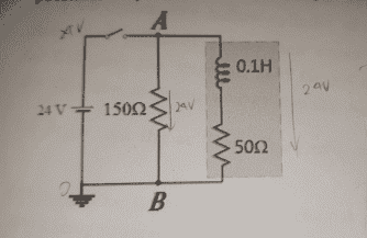

In the circuit the switch is closed for several seconds, then opened. Make a graph with the abscissa time in milliseconds, showing the potential of point A with respect to ground, just before and then for 10 milliseconds after the opening of switch. Show also the variation of the potential at point B in the same period of time.

[/B]So is there any potential larger than ground(V=0) on point A just after the switch is opened? In one way I think there should be some potential left since discontinuous change is unnatural. But I cannot clearly prove this. Also, the problems asks me to get the variation of potential B as time passes, but since point B is grounded, I cannot help thinking that potential of B is just 0 regardless of time. Am I wrong?

This would be correct.
Potential at point A will be affected due to opening of the switch. How would you apply KVL to the circuit after the switch is opened?

After switch is opened, what I know is that I should set inductor's emf like L*di/dt then apply KVL. But I feel confused when I have to set initial potential at point A after switch is opened. After applying KVL with potential B=0, I can get a exact potential at point A. So my question will be like 'Is A=24V just after switch is opened? Why?'
Point A will not be at 24 V immediately after the switch opens. It will be very different!
An important thing to remember about inductors for these type of problems is that they do not permit their current to change instantaneously. They will generate whatever EMF is required to enforce this rule in the instant after a sudden change in the circuit.
What this means in practice is that the instant after the switch opens the inductor will still be conducting the same current it did just before the switch opened. Your job in analyzing this moment in time is to find out where that current flows and what potential drops it causes.
You should draw two versions of the circuit, one with the switch closed with the inductor current direction and magnitude indicated. The second one should be for the instant after the switch opens and showing the inductor current identical to the previous diagram.

Inductor requires same current. Thanks! Now I think I can solve the equation... So does it mean that potential at A changes discontinuously from 24V to some other voltage when switch is opened? Does this instantaneous voltage change occurs in other circuits with switch?
Yes.
Whenever you have reactive components (inductors, capacitors) then they will exhibit this behavior. Inductors can't change their current instantaneously and capacitors can't change their voltage instantaneously.
