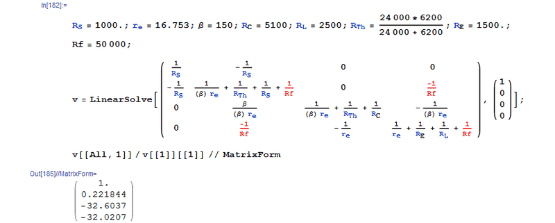

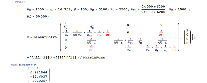

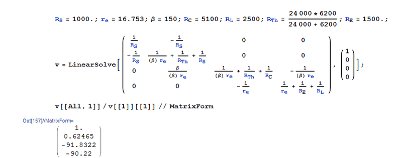

If I evaluate what I got using the indicated values for the components, the result is:
If I evaluate your expression, the result is:
I can't tell you where your mistake is, but there is apparently at least one.

The advantage of setting up a nodal solution as I showed is that you let the computer (or calculator) do all the mistake-prone algebra. The elements of the 4 KCL equations are individually very simple. You don't solve them individually; you just set them up, which is almost trivially easy.
They can be solved in various ways, but formatting them as an array gives a compact representation. Solving them as a linear system of 4 simultaneous equations gives all 4 node voltages at once. There is no "bulling through" required. The computer or calculator does all the algebra for you, without any mistakes, like this:
The answer is an array of the 4 node voltages, (vs, vb1, vc1, vo). Since the input vs was set to 1, the output voltage at vo, -90.22, is the gain Av.
You can instantly see that the gain from vs to vb1 is .62, and from vs to vc1 is -91.83
This problem was of moderate complexity. As soon as you have a few more nodes, probably with feedback, there will be no possibility of getting a mistake free solution doing all the algebra by hand. This method is what simulators like pSpice use.
The point of this exercise for the OP is not to plug numbers into a math program, nor even to get the right answer, but to understand circuitry, equivalent circuits, ac vs. dc analysis, etc. etc. You learn nothing from plugging raw numbers into math software. Even less by running pspice. I've used pspice for over 30 years but first I made sure I understood circuits. That's what the circuits courses are for.
To say more about all this. Your method of solution reduced the 4 unknowns to 2 by taking advantage of the fact that you didn't want vc1 anyway, and that vs is a known since it is the node where we want to inject our input.
Setting your 2 KCL equations equal to each other is how you solved 2 simultaneous equations., with a considerable amount of algebra.
When you use a computer to solve systems of simultaneous equations, it's no harder to solve 20 simultaneous equations than it is to solve 2.
As an example, imagine that we want to improve the linearity of your circuit. We add a 50k ohm feedback resistor from vo to vb1; let there be a large capacitor in series with it to avoid upsetting the DC bias. You still have 4 nodes, but you will find that the problem becomes very much more complicated using the method you did.
But, if you have already got the system of 4 KCL equations set up, it's a trivial matter to add the feedback resistor, and let the computer do the additional work.
Here's the system with the feedback resistor added (in red); you can see that the additions to the equations are trivial. Solving the system with a linear solver by computer easily gives the result shown. Av is reduced by about a factor of 3. The only extra work to do is to add 4 elements to the system:
I know you're a busy student, but if you give a try to solving the circuit with feedback by hand, you'll appreciate just how much the addition of one more resistor complicates things.

GreenPrint said:
Also where did you get [itex]R_{f}[/itex] from?
The Electrician decided he would add a little spice to this rather bland problem, so he added an extra resistor to give feedback to (according to theory) improve the performance of your basic amplifier.
He changed the circuit just for fun. :smile: Rf is his feedback resistor ("We add a 50k ohm feedback resistor from vo to vb1").

GreenPrint said:
Believe it or not, this question appeared on of my examinations which I got wrong. I know that during a test I would rather much not solve this problem using algebra and that solving it using matrix would be much easier and allow for less errors. I could plug the values into my TI-84 and get the answers. I think perhaps it's a good idea to solve circuits like this by hand, but when it gets more complex it's just down right a waste of time, and when during an examination it doesn't make much sense to plug through the algebra.
I don't know just my thoughts.
You would be surprised how fast the solutions for network problems like this grow with the addition of just one or two more nodes, or additional parameters. The current problem is just about the limit of what you can reasonably do without the algebra becoming so cumbersome that it can't be done without mistakes.
Single transistors are often described at low frequencies with 4 parameters, hie, hfe, hre and hoe. In student problems it's almost universal that hre is taken to be zero (ignored, in other words), and typically, hoe (also known as ro) is taken to be zero. If, in your problem, hre had not been zero, your algebra would have been totally out of hand.
