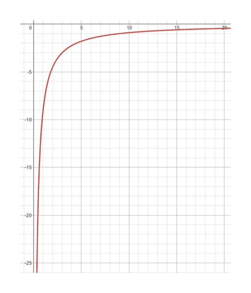

does that mean that potential energy is asymptotic to 0 as a function of r when the charges are opposite?
  • Graph of a negative function against r, rising steeply toward zero as r increases, with the curve plunging down toward negative infinity near r = 0 and approaching the horizontal axis asymptotically at large r.
Exactly correct!
P.S.: Nice graph! From it I conclude now that you are indeed familiar, not only with positive and negative numbers, but with all Real numbers in general, as well as Calculus.
