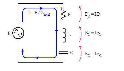

The ac circuit has 3 components in series: a Capacitor C=120μF, an Inductor L=100mH, and a resistor R=7Ω.
A) Find the amplitude of the voltage across the resistor R in the LCR circuit below, when
operated at a frequency of 45 Hz?
B) What is the phase difference between this voltage and
the supply voltage, Vac (= (15 V)cosωt)?
C) At what frequency is this phase difference zero?
D)What is the Q value of this resonant circuit?

Okay, you're given the frequency of operation. Can you calculate the individual impedances of the capacitor and inductor?
Yes, the complex impedance of a capacitor is (1/(iwC)) and the Complex impedance of an Inductor is iwL. So I could calculate the individula complex impedances of both comfortably.
So then, what's the total impedance of the series circuit (numerically)?
This is frustrating. When I use the complex impedance formula for a capacitor to be (1)/(iwC) I get a total circuit complex impedance to be = ((0.042)/(i0.0339)) + 7. The when I use the other capacitor formula for complex impedance -(i)/(wC) I get the total complex impedance of the circuit to = -i0.042 + 7. So lost with the whole question :(
Let's do it one step at a time. What are the individual impedances for the components?
1) Complex Impedance (C.I) of capacitor = 1/(i)(w)(C) where w=2pif.
Therefore plugging it ---> 1/(i)(2pi)(45)(120E-6) = 1/i(29.5)
2) C.I of Inductor = iwL therefore plugging in yields ---> i(2pi)(f)L = (i)(2pi)(45)(100E-3) = i9pi
3) C.I of resistor = R therefore = 7They are all the complex impedances arn't they? What now? Thank you!

Presumably that's meant to be (1/i)(29.5) Ω. Which is -29.5i Ω, after multiplying top and bottom by i. That's a good value. A better one would keep a couple more decimal places as guard digits for future calculations -- Don't round intermediate values.
Something went awry there. ##2 \cdot \pi \cdot 45## is about 283, and multiplying by 100 E-3 can't change the digits...
Correct.
Once you've sorted out the inductive impedance value you can write the total impedance for the circuit. Z = ?.
With that you can use Ohm's law to find the current, potential across R, and so on.
And while we're at it, in your first post you calculated the Q using the driving frequency of the source (45 Hz). It should be ωo as you wrote in the expression for Q. ωo is the resonant frequency of the RLC circuit.

Careful, the impedance of the inductor is also imaginary, like the capacitor's. jωL.
but if I were to use ohms law to find the voltage amplitude like part A wants me too would the following be correct: Ohms Law: Zr = Vo/Io = R. Therfore Io = Z/R = 7/7 = 1. Then rearranging Vo = RIo = (7)(1) = 7.
Ohm's law: E = I*Z, so that I = E/Z.
Find the total current I first. Then for individual components with impedance z, Ez = I*z.

E is the potential (or voltage). I use E rather than V since V is also the unit (Volt). Avoids confusion that way. Since you're not given a specific value for E at this point in the problem, express the result in terms of E.

Since it's a series circuit the current must be the same for all components. That'll be your E/Z value, where Z is the total impedance. That same current flows through each component and produces potentials across them.
Your value for I total is okay, but you might as well normalize the complex value (divide both terms by the 50.44 so you have a canonical form of complex number: a + ib). As it turns out, that complex number that you determined is also known as the admittance of the circuit. Admittance is the complex analog of conductance. Where G = 1/R for resistances, Y = 1/Z for impedances.
So if you calculate Y = 1/Z, then the current in the circuit is E*Y. That's Ohm's law in terms of admittance (conductance). And the potential across a component with impedance z is then E*Y*z. You can pick out the expression that represents the "multiplier" of E for the component's voltage.

I*z is the give you the complex voltage across z. |I*z| is its amplitude.
Y=1/Z so Y = 1/7-1.2i. You then said potential is E*Y*z so my potential across my resistor is then :
= ((E)(7))/(7-2.1i)? I am struggling to find how I am going to get the amplitude across the resistor. Sorry for being slow at this but I can't see where we are going with this.

Yes, the potential across the resistor is given by ((E)(7))/(7-2.1i). Put 7/(7 - 1.2i) into the standard form: a + bi. Then the potential across the resistor is (a + bi)E. E is currently an unknown quantity so you leave it as E. But you can take the magnitude of a + bi, right?
This is just a use of Ohm's law. You find the current through the circuit using Ohm's law with the total impedance and the source voltage E. Then you find the potential across an individual component using that current and the individual impedance of the component. The only complication is that you are working with complex values rather than real values, but the basic procedure is the same.
FYI, here's a diagram of the circuit under discussion, if that helps.
