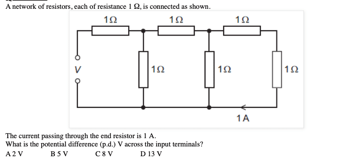

Can anyone help me with a worked solution to find e.m.f in the following diagram
Kirchoff's Laws
You can solve the formal matrix of node potentials. Only 4 nodes here.
Or you can come to answer (D) noticing what the potential at upper-right connection dot is 2V, and replacing resistor branches from right to left by equivalent current sources.
