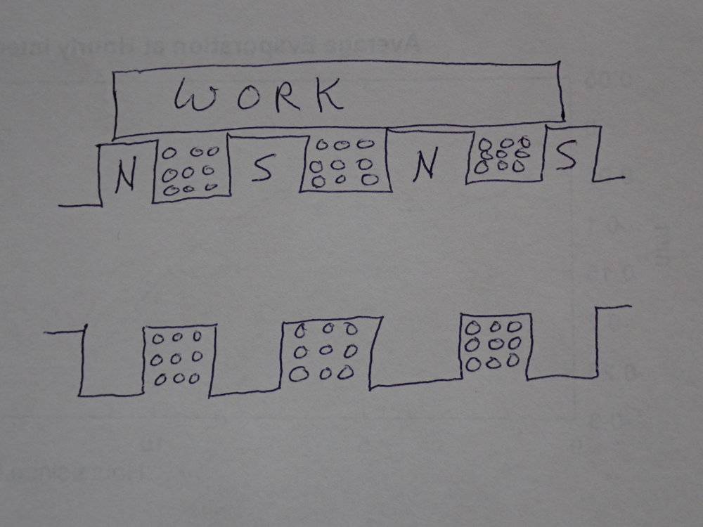

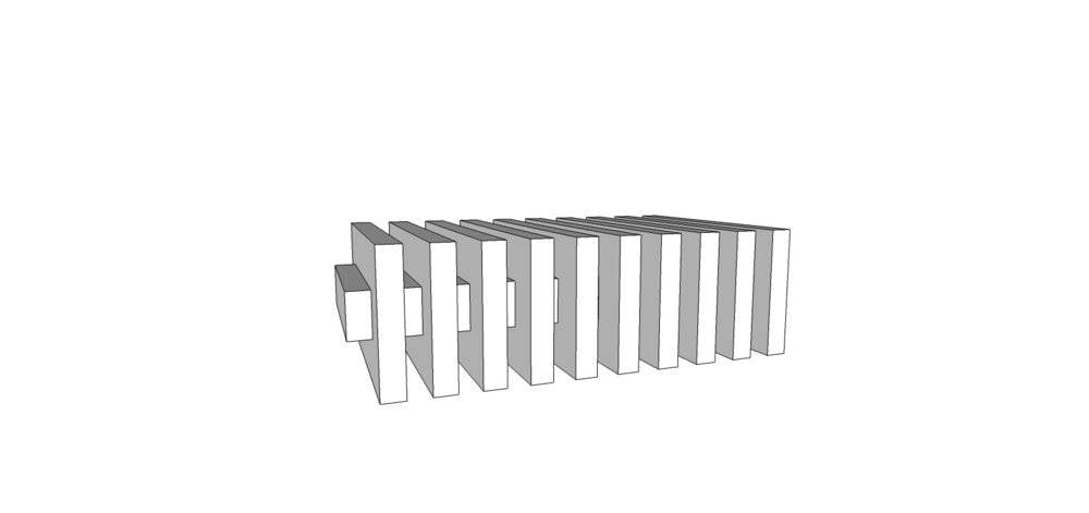

Alright the attached picture has the two physical layouts I'm considering for the chuck, however I'll admit that looking at the math involved to determine the construction of the individual magnets and a knowledge gap in how best to manipulate the construction of such a thing to have the greatest amount of uniform attractive force over the surface area. Something in the range of 30-50 lbs per square inch.
My target face area for the chuck is to be 10" by 6", height can vary a good bit, but I'm aiming for a 2" height.
So, firstly, do you think my overall aim here is realistic and something that could be cost effective? My time on this isn't a critical consideration, so it's more down to materials cost.
Secondly, I have no idea on how to determine the effectiveness or best means to determine how overlapping magnetic fields are going to function and what arrangement would be optimal. Any guidance or direction on how to determine such a thing would be greatly appreciated.
Lastly, I know I'm asking a lot on this one and that I am admittedly having problems seeing how to convert the values I'm after (voltage, amperage, pull strength) into the number of windings and size of the iron core. Anything to clarify or help me work through how to translate from one to the other would also be wonderfully appreciated.

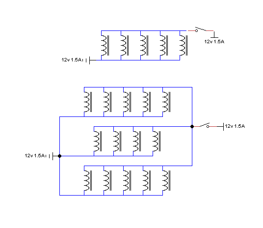

Provided I'm following your hint correctly I've changed how the circuit for the chuck is wired.
Thanks for your hint and asking me to provide some further information, I don't like designing stuff in a vacuum.

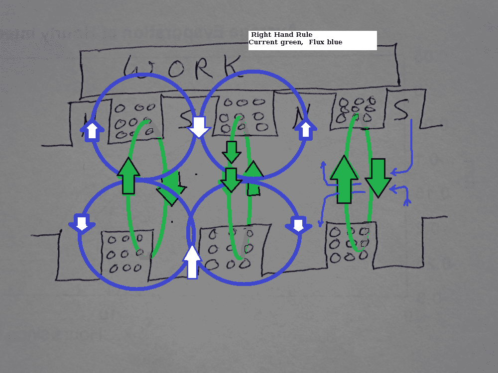

Your magnetic chuck is an electromagnet. It's been a while since I designed an electromagnet, but I'll give it a shot. Start with the mechanical design, then work on the electrical. I think that the design sketched below will work, but don't take this as the final word:
The wires are shown as little circles because they run in and out of the page. Into the page at the top, down on the back side, out of the page on the bottom, and up on the front. The slots are sized to be large enough to hold the wire. The width of the poles is determined by minimum work thickness, they should be roughly equal to the thinnest workpiece. The individual coils can be connected in either series or parallel depending on their resistance and your power supply.
One Tesla flux density has a holding force of 58 PSI, and that force is proportional to the flux density squared. Steel saturates at about 1.5 Tesla. You calculate the ampere-turns needed to get the desired magnetic flux density through the poles and workpiece. After you calculate the ampere-turns needed, you choose the number of turns. This is an iterative calculation. More turns = less current and more voltage. Larger wire = less resistance, but it needs a larger slot. For a constant slot size, larger wire and higher current will generate the same amount of heat as smaller wire and lower current. So you balance wire size and number of turns against power supply voltage and current. The Wikipedia article is a good place to start for the calculations: https://en.wikipedia.org/wiki/Electromagnet.
The magnetic circuit goes from an N pole, through the workpiece, through the nearest S pole, and through the chuck to the N pole. The wires are wound around the chuck, then potted in epoxy.
There's a lot more, so study the Wikipedia article, attempt some calculations, work on the mechanical design, and then come back here. Good luck and have fun. It sounds like a great project.

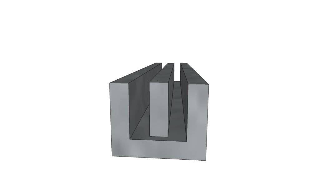

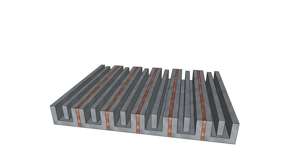

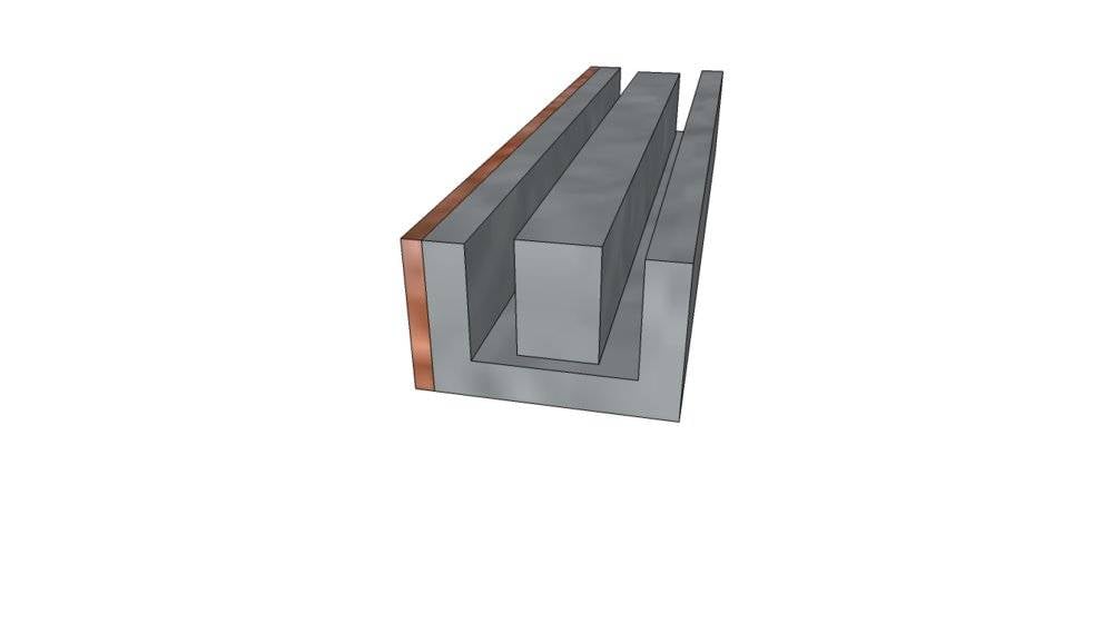

Alright, I think you're talking about the core being a solid chunk of iron formed like this?
And the windings wrapped around the narrow sections?
That seems counter intuitive to me as I thought that the majority of the magnetic fields would be formed blowing out the smaller ends at the left and right rather than the top and bottom.
Further having a continuous magnetic surface like that seems like it would only attract the work to a single point.
I was thinking that each magnet would be a separate thing with a copper or other non-magnetic spacer separating the magnets like this:
Obviously I'm not quite following, but hopefully the images there explain what I was thinking.
As far as the math? I'm still trying to figure out where to start there. I'll be following this with a more general post trying to better explain where my confusion is.

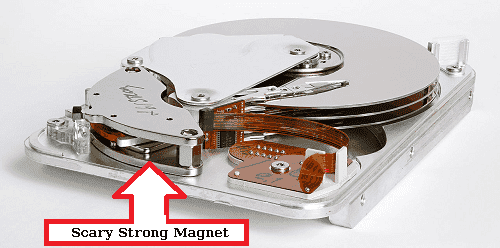

If you can figure out how to use one,
a source for incredibly strong magnets is old hard drives from dead PC's. Computer shops often give them away.
Used to be a lady on Ebay who sold the magnets already removed , and if you don't have security torx bits to take the drive apart it's worth the price in avoided aggravation.
they're nice and flat, easy to mount and grab so hard you have to pry them apart.
I used one to hold the end on a paper towel dispenser , sure beats unscrewing a long threaded bolt to change the roll.

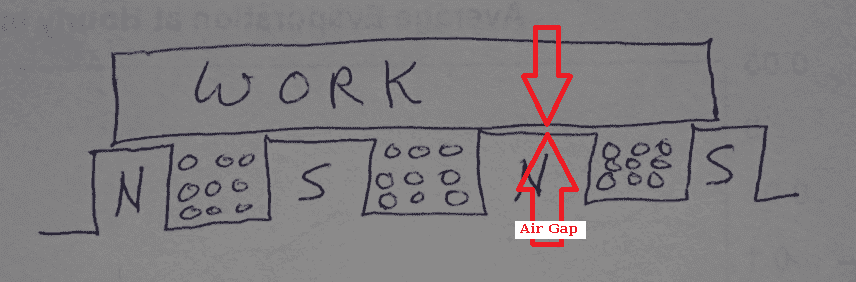

...... Now.. ... To what i think it is you're asking... beware, I'm famous for answering the wrong question ..
How many thousandths of air gap do you expect?
Thegeneral formula for magnetic flux density B in Teslas is
B = μμ0NI/Length
where μ is ~1 and μ0 is 4π X 10-7
N is number of turns
I is amps
Length is your air gap in meters
That'll be a little optimistic because iron is not a perfect conductor of flux, but it's so much better than air you'll hit within a few percent for reasonably small gaps.
You're interested in amps and turns
and since 1 Tesla is about all the flux you can squeeze through most iron that'd be a good target flux.
So rearrange that formula to put NI on left side
NI = (B X Length ) / (μμ0)
B= 1 is our target. so
NI = 1 X Length / 4πX10-7
NI=. Length X 7.96 X 10^5 amps
or 7.96 X 10^5 amp-turns per meter of air gap
or 796 amp-turns per millimeter of air gap
and a millimeter being approximately thirty-nine thousandths of an inch,
that'd be about 796/39 = real close to 20 amp-turns per mil of air gap.Since your work covers adjacent poles you should achieve nearly a Tesla
and here's a page with a practical formula for clamping force
http://www.magneticsolutions.com.au/magnet-force-calc.html
That's Teslas, Newtons and square meters...
i get about 40 Newtons (nine pounds) per square centimeter of pole area at 0.001 air gap, twenty turns of wire and one amp through them..if you can squeeze into your slots a hundred turns of wire big enough to carry a couple amps you'll have 'headroom"
and i think you should have a robust chuck that you could power from a very modest source maybe even a cellphone charger. .
check my arithmetic please ?
I think that's a valid approach to what i think you asked - how to figure out the electrical part of it. If i missed please advise.
Corrections welcome

What i meant...
get two permanent magnets and note how quickly force drops off with distance.

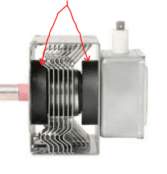

Since you mentioned microwave oven
the magnetron has two really nice circular magnets , just right strength for really good fridge magnets.
But if there are tiny fingers in the household beware for a pair of those magnets can give a child's finger a painful pinch.
I'd suggest arrange your grinder so it'll throw a loose workpiece at a wall, and maybe glue a slab of styrofoam there for an energy absorber should that happen.

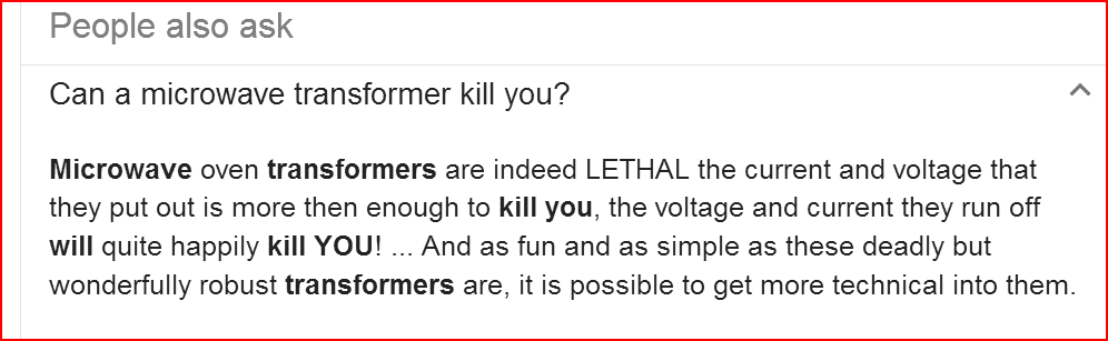

Please do not consider using microwave oven transformers. They involve high voltages, which are not safe for an inexperienced person to work with. Thanks.
EDIT/ADD -- From a Google search on Microwave Oven Transformer Voltages:
(I'm still having trouble parsing that last sentence in the quote, though...) o0).

I'm confused still, what makes one "rib" north (N) up and the adjacent "rib" south (S) up? What makes them alternate?
Direction of his windings.
He'll alternate the direction he winds them CW CCW CW CCW etc.

I think the experimenters use the MOT for lifting by sawing off an end and using it as an E-core electromagnet , applying a few amps of DC from a battery charger.
but you never know.I repeat my admonition -
NEVER energize a MOT until AFTER you have physically cut off and removed that high voltage winding.!
MOT's are killing neophytes.
old jim

Some more points:
1) One of the limits of a magnetic circuit is the thickness of the workpiece relative to the electromagnet pole width. When the steel in a thin workpiece is magnetically saturated (about one Tesla), that limits the flux in the rest of the circuit. @jim hardy can explain it better than I can.
2) If you plan on clamping a piece of hot rolled steel onto your chuck, figure on 0.005" or so of mill scale AKA air gap. Or if you clamp a piece on a surface that is not machined flat. Either case will require more ampere-turns to get the clamping force. I once designed an electromagnet to pull 1600 lbs over a 1/8" air gap. I used 10 gauge wire and a 50 amp power supply. It worked exactly as designed.
3) Styrofoam is as combustible as fuel oil. Sparks will set it on fire. I tested that once with a match and a small piece of Styrofoam held with a pair of pliers. It flared up faster than I could drop it. I read of a case where somebody insulated a pole building with Styrofoam on the inside, then set a grinder near the wall. The grinder was right next to the door. The foam caught fire and he barely made it out alive. Use a piece of plywood instead.
4) The following electromagnet configurations are equivalent:
If the dimensions are the same, and the total turns and current are the same, the pull force will be the same.
Likes jim hardy and Marc Banks
Currently I'm thinking that this going to be the best coil design for the individual cells. Each cell is 1.25" wide and about an inch tall. I'll be milling one of these out of some old scrap cast iron at some point, then seeing how the individual cell pulls until I have it tweaked how I need it for the chuck.
I'm intending to run the windings in the same fashion as you would on using a single coil on a transformer. I'll be spacing them with 0.25" copper and wired in parallel. So the bones of the chuck without the windings will look something like this, I think:
Thoughts?
Make the center piece twice as wide as the end pieces as is crudely shown in the sketch in post #21. If you connect the coils so that every other cell is magnetically N-S-N, with the adjoining cells S-N-S, then there should be no need for the copper and you will get more clamping force.
Wind the coils on a separate mandrel and make them slightly longer than the center pole. You do not want the ends of the center pole to butt tightly inside the coil because that could damage the insulation and short circuit the coil. Pot the coils in epoxy. That can be done by clamping dams to the ends, then pouring the epoxy onto the coils. Pour in some extra because it will take time to penetrate between the wires. Pour on too much, then grind the whole thing down after it hardens. Polyester resin will also work, but not as well as epoxy. Polyester resin is the stuff sold in hardware stores as "fiberglass resin". The coils need to be potted because they will be buried under metal chips, which will grind their way through the insulation.
Don't forget to grind flat the bottom of the chuck.
Likes Marc Banks and jim hardy
So more like this?
Yup.
And be sure to let us know how it turns out.
jrmichler said:
Yup.
Might be a month or three before I get too far into it, go an injection mold to finish and some electroplating to do before I can put time to this.
dont forget to leave some extra meat on the working surface so you can grind it flat and parallel, too.
